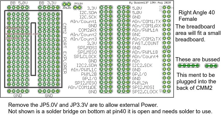

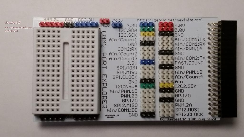

Got the boards in and here is a look.
and a work sheet
Let me know if there is any interest in this.
I have ten boards, colour pin set and RA 40 pin.
This is a spinoff of the MM170 Port Explorer I did for a group of kids.
It will need something to hold it up to match the level of the CCM2 40 pin.
Could try one of those pink erasers under the breadboard area.
I didn't find more than six colours of the pins or I would have done the SPI's too.
Have in FUN

Nice work there.
But which pis are "bussed"? not clear from your diagram. I assume its the two central banks of 3pins per i/o connection?

Posted: 12:41am 23 Sep 2020
Why did you go with a direct connect to the 40pin on CMM2 instead of a male 40 on the explorer like the RPI GPIO breakout boards?  This looks like a great device.

Womble
  Quote  But which pis are "bussed"? not clear from your diagram. I assume its the two central banks of 3pins per i/o connection?
The groups of three pads from the 40 pin interface and groups five pads in the breadboard area.
mclout999
  Quote  Why did you go with a direct connect to the 40pin on CMM2 instead of a male 40 on the explorer like the RPI GPIO breakout boards?
I did the CCM2 Port Explorer like the MM170 version where it can be checked by
a teacher/peers to make sure the wiring is good before plugging it in and powering up
the CCM2.
The 40 pin on the CCM2 is male and this is to be plugged into it.
Ease of use for kids learning to do software/hardware relationships.
At last minute before ordering the boards. I added the two GND pins between the 5Volt
and 3.3volt buss above the breadboard to make it easier using an external supply for the breadboard.
To use the CMM2 power plug in the shorting blocks on the JP5.0V and JP3.3V jumpers
but only if not connecting to external power.

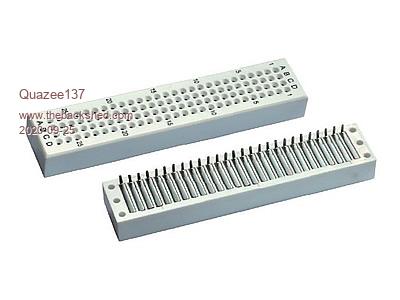

what would be really cool would be if the board had silkscreening on BOTH sides, so that it could be assembled with all components on the opposite side to normal, and then sat on TOP of the CMM case with a short ribbon cable curling round to the 40-pin CMM2 I/O connector, and with the breadboard section at the front.
and i could see many users in the above configuration wanting to replace the solderless breadboard you've specified with one of these ones:
https://www.ebay.com/itm/261917558371

  Quote  what would be really cool would be if the board had silkscreening on BOTH sides, so that it could be assembled with all components on the opposite side to normal, and then sat on TOP of the CMM case with a short ribbon cable curling round to the 40-pin CMM2 I/O connector, and with the breadboard section at the front.
Rob these where made for classrooms that share the CCM2's. Having the students wire
up their work and then have a Teacher or peer review before plugging into the CCM2
and powering it up. I have other designs in the works using these.
I can not get these in small amounts other than samples. They want me to order
them in the 100's.
The smaller breadboard was used as it fits the space and I think for most student
projects it should do. I to like the bigger ones with power rails just too big for
this version.
Rob have a look at this. Scroll down near bottom.

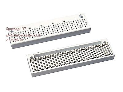

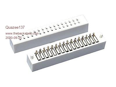

CircuitGizmos
Joined: 08/09/2011
Posts: 1427
Posted: 04:33pm 25 Sep 2020
  Quazee137 said
Didn't know they made these. Where is your source?
Posts: 2983
Posted: 08:10am 26 Sep 2020
Hi Quazee, All
What he said..
I have never seen them before.. I bet they arent cheap though.
