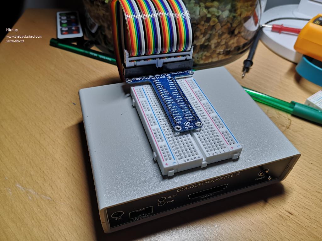

I use my CMM2 with a ribbon to breadboard adapter (a Ras PII one).  As per the manual, I needed to manually "adjust" the keyway so that ribbon cable pin outs match the CMM2.
All good stuff - and works a treat. See image below.

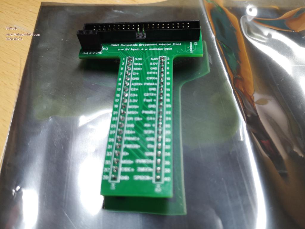

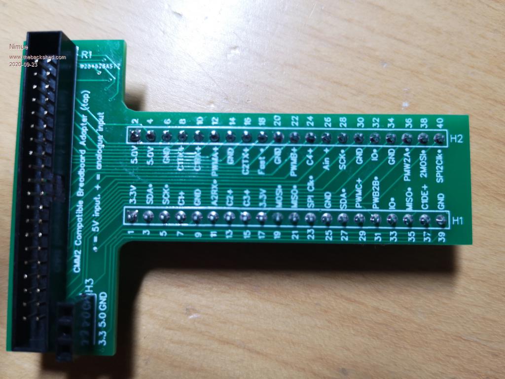

However, as the labelling of the pins is Pii specific and I didn't like the fact of hacking the IDC header.  So I fired up EasyEDA, and designed a new one... I sent the finished PCB to PCBWay and 8 days later x10 of these beauties arrived:
All lovely silk printed and with the IDC header on the right way round..
But in my haste, I designed using a 2mm pitch IDC header as opposed to 2.54mm pitch.  So -- I need a "solution" or "fudge" take your pick...

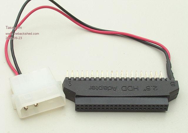

Back in the distant past when HDDs were IDE, we had 2.5 to 3.5 IDE adapters.
You would have to remove  some of the pins on the 2.5 side (or get a bigger hammer).
They would probable cost more that getting new boards made...
Some of them have a pin missing supposedly for keying but I am sure it's just to annoy us.

  TassyJim said  Back in the distant past when HDDs were IDE, we had 2.5 to 3.5 IDE adapters.
Now, that's an interesting beast >> I'll investigate.
Fingers crossed that I've manage to source some "samples" ;-)

As Jim mentioned 2.5" to 3.5" IDE adapters might solve your problem, something like this.  Some work with a multimeter to check the connections would be necessary in case some pins are not connected, or ar tied together.
