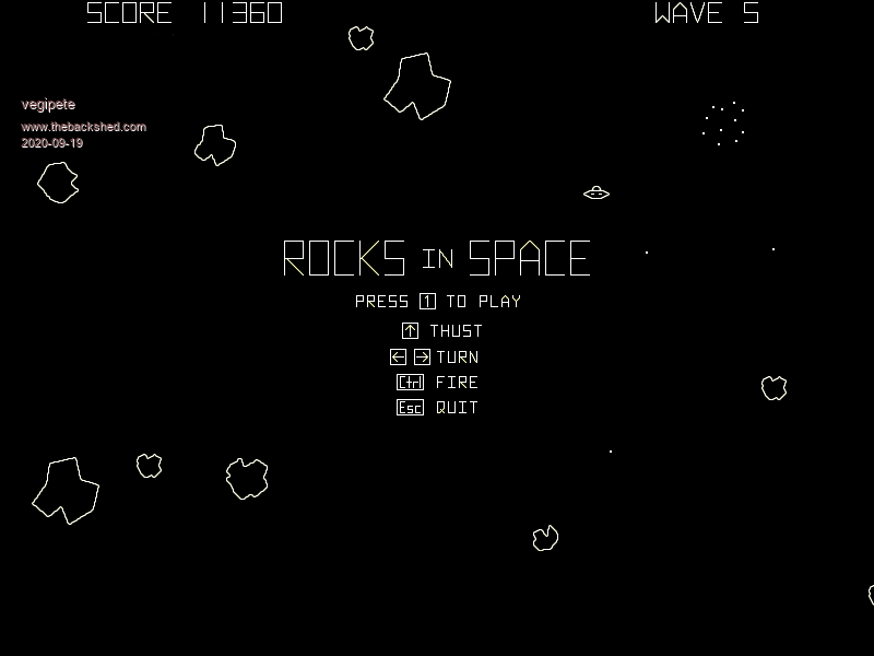

Sorry, no hazard pay.
The time has come to release a preliminary version of Rocks in Space!
As the image suggests, this is an Asteroids clone. Most functionality has been implemented and now it's time to let others help find more bugs.
Not done yet:
volume control,
high scores,
player/ufo collisions,
ufo sounds, although they may never happen
I am unsure how accurately I have recreated ufo flight and firing characteristics, particularly the little devil, who's aim gets better as your score increases.
As always, have fun, and let me know what you discover.

sweet!

Curse you for creating great stuff that I can't appropriate for the Welcome Tape; somehow I don't think Atari/Hasbro will be as accommodating to a request as Scott Adams was.
Lovely work,

D'oh! This is exactly what I wanted to do as my first game project on CMM2. You beat me to it. Looks great! Congratulations!

Neat!
I would like the opportunity to land on some special asteroids and have some cover for a few seconds.

I got as far as random rocks moving.
Nice one.

Absolutely brilliant port. Very playable.
I wasn't expecting it to feel this polished, but polished it was.
Out of curiosity alone - I wonder if running it in a lower res will push up the framerate (still very very playable at the current frame rate)?
I tried changing the mode and it didn't work (I thought it wouldn't). Just curious if there is a bottleneck at 800x600 on the blit throughput, or if it is bottlenecked elsewhere.
Even so, 20fps at 800 x 600 is excellent, meaning that there is tons of headroom at regular gaming resolution of 320 x 200 or 320 x 240.

Yeeeeah.  Well done!  This is a great remake of an Arcade Classic!  Seems quite playable from the keyboard.  The original used a vector graphics CRT, but at 600x800 this looks quite good.

I forgot to mention, the number displayed bottom left is the time to generate each frame, in milliseconds. The program keeps each frame at a minimum of 35 milliseconds, so when that number goes over 35, it will start to lag or stutter. 35ms is 28.5 frames per second. Pretty impressive frame rate for interpreted BASIC!
Painting the screen and performing game logic are fairly independent.
If you look at line 612, you'll see half of the print statement commented out. Remove the comment character (') to print the second time value.
The entire frame time is "timer - t1"
The game logic time is "timer - t2"
By extension, "t2 - t1" would be the time to paint the screen.
Generally, more time was spent doing collision checking than painting the screen, so changing resolution won't make a dramatic change to frame rate.
And sorry, I wasn't very diligent at making the program graphics mode independent. Screen resolution based magic numbers are all through the code. Often they are 5, 10 or 15 or whatever more or less than MM.HRES and MM.VRES.

Very nice! It plays just like The Real Thing :)

Wow! Awesome job. I love how authentic it feels to the original, even down to the way the space ship explodes when destroyed. Definitely a labour of love. Thanks.

Hi ! Great game !
I would make the game over screen a little bit shorter... so you don't have to wait that long for the option "1" to come in again... (People have no patience ;- )

You can press "1" immediately to play again. You don't have to wait for the message.
