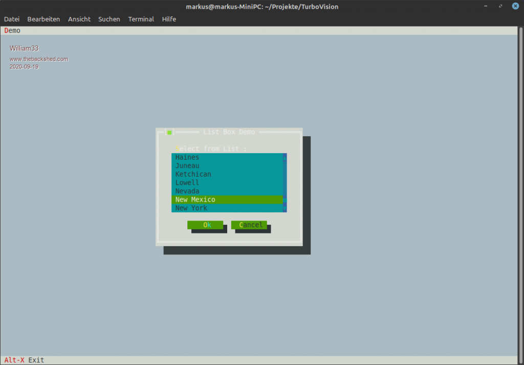

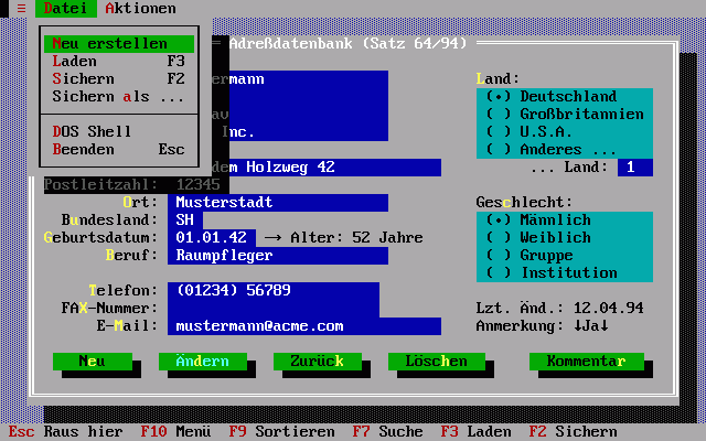

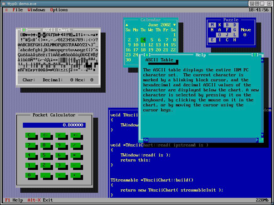

You either tabbed or arrowed around until you reached the target widget, or you used a shortcut key - note in the first screenshot every screen item has a unique letter in red or yellow, which is the keystroke associated with it.
Typical Windows BIOS configuration screens are an artifact of this keyboard-only UI method.

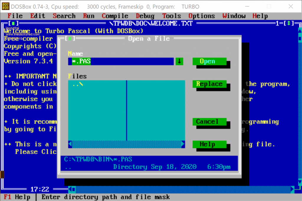

Apropos this TUI thread, and various other ones about MMBasic’s text editor, I have very fond memories of the TurboPascal package and its built-in editor. I ended up using that Turbo editor to edit everything - it was vastly superior to any of the “default” CP/M and DOS editors at the time.
Feels like a DOSBOX kinda weekend coming up :)
