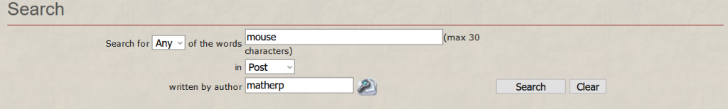

I did the following search ...
and found this post ...
  matherp said
