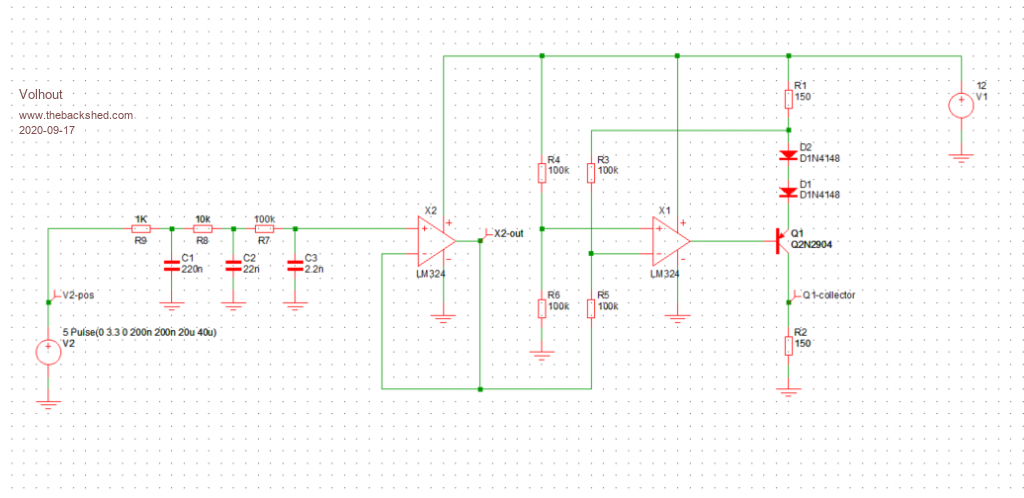

IF you want to read analog, and write PWM fast, a high PWM frequency is needed with a suitible low pass filter. Look at the backpack tracker passive low pass filter that is matched to the MM2 100kHz (or 120kHz) PWM output.
schematics
Of coarse you need to replace the voltage output of the LM741 to a current output (0-20mA).
Edited 2020-09-14 16:59 by Volhout

In case you need help with the design of the circuits I may be able to help you.
Would need some more information from you though, like what voltage you have available that is higher than 3.3V and 5V (for the backpack).
The 0-20mA suggest PLC type sensors and environment, and is designed to work with higher voltages. I.e. 4-20mA sinks can easily require 5V or more as minimum driving voltage.
And I need to know the required resolution. The MX170 ADC is 12bit (max). The PWM however is a balance between speed and resolution. At 100kHz (the backpack tracker) the resolution is poor (1% or so), if you need more resolution the PWM frequency must be lower, and the output becomes slower. The lower the frequency, the higher the resolution.
For analog temperatures, or DC voltages this may be perfectly OK.

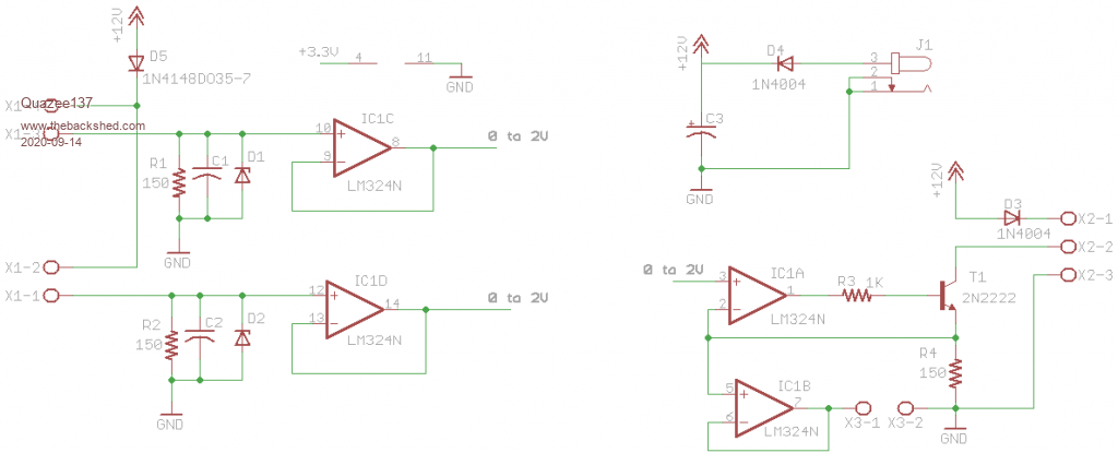

Here is whats left of the analog way. I cut out all the other op-amps doing
some basic adding/subtracting of the two inputs to drive the 4-20mA out.
I changed from 5V to 3.3V on the LM324. I wanted to change to the MM170 for
its display and touch removing four pots and trimmers. Also can do much more
math wise this way. Even setting different curves. I called it a 4-20mA mixer
at first but the need to have better control of how they are mixed/blended.
Made the analog way to expensive with 10 or 20 turn .1% pots and trimmers.
Using the MM170 will give more flexibility and having the inputs and output
displayed will be a major plus. Having touch for a menu system over the pots
will allow me to play with controlling/testing this in a smaller box.
Thanks Volhout for your help.

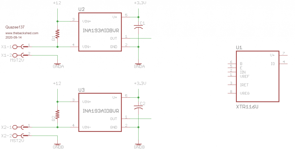

I am now looking at a newer way to do this these parts make it even smaller.
I could be making a MM170BP size board. Will need to get the 1.8 and 2.4 LCD
displays out and see if a smaller touch area will do.

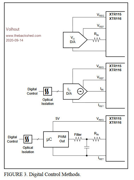

The XTR116 is not the most suitible part since it has a current input (not a voltage input), but I think we can make it work.
The upper circuit (opamp output = voltage -> through Rin convert to current) would give best linearity, but the lower one (PWMout -> low pass filter -> Rin) can also work if we dimension the low pass filter impedance correctly.
I would need to know from you what the fastest change is that you want to support in your circuit. i.e. 10msec, or 100msec. And the resolution (i.e. 10 bit, or 8 bit or...). Then I can calculate the filter and PWM frequency for the MM2.

I ok using the LM324 for the 4-20mA out as I have used that in other projects.
I was looking at ways to shrink the board down. So I can use LM324 SOIC package
and do both inputs and output as in my original analog work.Just put the MM170
in between the inputs and output to allow for better/lower cost way to do the
math.
Now thinking of sliders on screen to adj a percentage of each input to output.
It makes calibration easier put 4mA save it then 20mA and save it getting the
16ma slope for each input. It also makes adjusting the output slope easy.
It now can be used as a tester being able to read and send 4-20mA even 0-20mA.
I have the LM324 on the breadboard and will play with it and the MM170 thanks
to your letting me know more about how the frequency comes into play.
The initial use is flow meter and Turbidity-Sensor feeding a chemical pump.
Thanks again for you knowledge with the MM170 PWM.

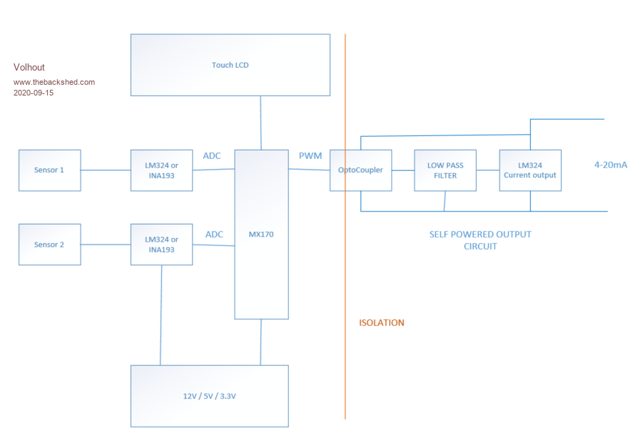

Posts: 6214
Posted: 06:31pm 14 Sep 2020
One thing to bear in mind is the isolation. In the input circuit with lm324 the pos. input is hard wired to +12v, and the neg. input varies. In the INA193 circuit the pos. Input varies, the neg. input is hard wired to ground. Both are no problem, but indicate that the current Output of your mx170 should be able to handle both.
Wich means the output should not be hard wired to ground, or +12v, meaning it should be floating, isolated.
The block diagrams of the xtr116 also suggest that. Your LM324 output cicuit will also require a isolation. Isolation of a PWM signal is easy, use a digital optocoupler. And the 4-20mA can power the floating circuit. As the xtr116 circuits show.
Do you have good experience using the lm324 at 3.3v?

Posts: 6214
Posted: 06:08am 15 Sep 2020
Hi Quazee137,
I looked up a few turbidity meters, and typical response times are 2 seconds (i.e. Mettler). That means that there is not reason to go for fast response time of the system. I suggest to design for high accuracy. That also makes the choice for optocouplers easier (we don't need a fast digital one).
I'll look into the output circuit this evening, have to rush to work now (it's morning here).

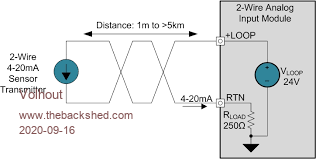

Posted: 10:34am 16 Sep 2020
Hi Quazee137,

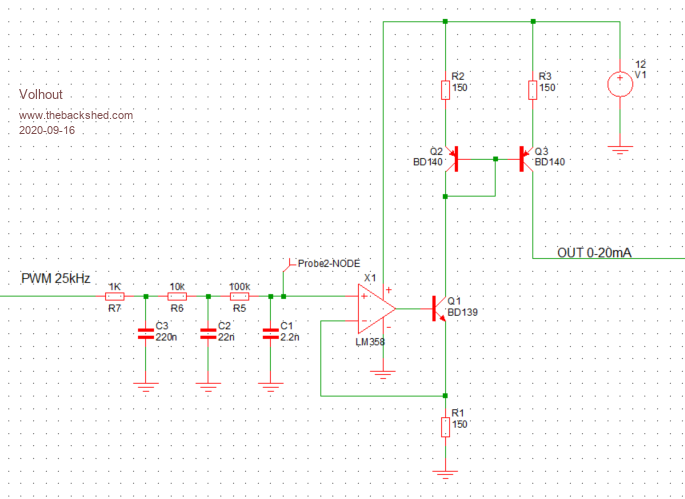

The industry standard for connecting 4-20mA sensors ties the + to 24V, and the - to a current sensing pin that connects to ground (exactly as your LM324 input circuit).
See this diagram:
Using this knowledge for the output circuit, we can avoid the isolating opto coupler if we source current (not sink current). In simplest form this would result in following circuit:
According to the MX170 documentation the PWM has 0.1% accuracy when the frequency is below 25kHz. So we pick 25kHz as PWM frequency. The low pass filter has a ripple that is 0.1% of the PWM input signal, in line with the accuracy.
The step response has a delay of 1ms for 63%, and is accurate within 1% at 3ms. That is way faster than the input will vary.
The current output (your LM324 circuit, only powered from 12V) feeds a current mirror (Q2/Q3), as a simple solution for sourcing current (not sinking). The transistors Q2 and Q3 should be thermally coupled for best performance.
There is one caveat: heat.
When powered from 12V transistor Q1 dissipates up to 120mwatt, but Q3 can dissipate 180mwatt. Using 12V you can replace Q2 and Q3 with one dual transistor, in which case the thermal coupling is perfect. For 12V Q1 can be an SOT23 2N2222, and Q2/Q3 can be a BC856S dual PNP transistor (ambient 25C, max 40C).
If you use 24V, the dissipation in these parts more than doubles, and you need the transistors (or similar) as shown in the schematics to get rid of the heat.
If needed a circuit can be designed that does not use the current mirror (less dissipation), but that will require another opamp. I understood you wanted a compact circuit. This is as compact as it gets...
P.S.

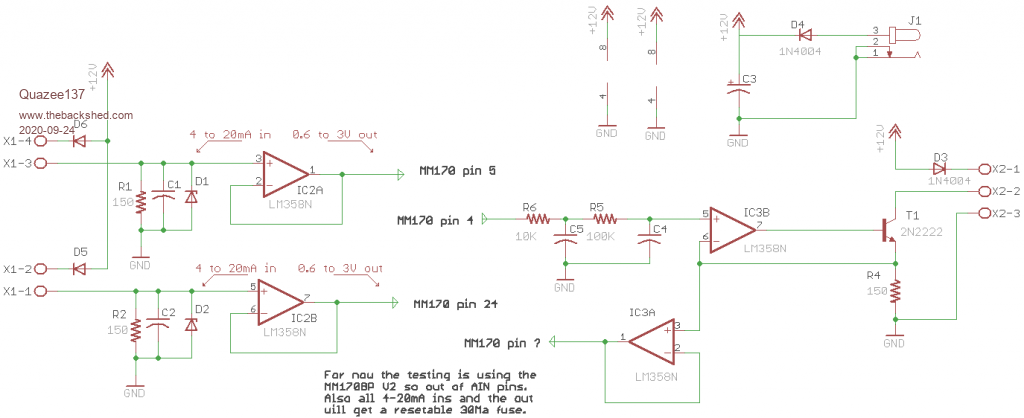

Posted: 11:58am 24 Sep 2020

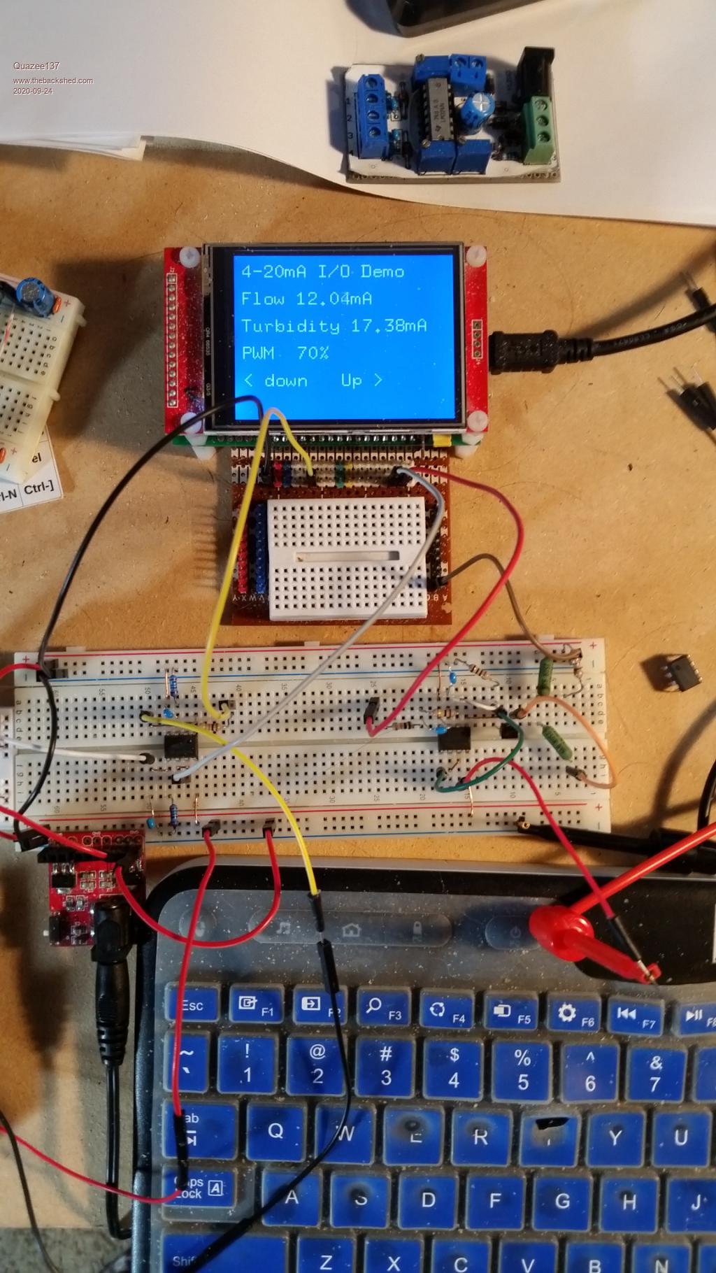

Volhout had time to breadboard the basic PWM to 4-20mA output and two 4-20mA
inputs along with a bit of test code to play with.
Here is what I am playing with. Things are working. Next adding resetable
fuses to the three 4-20mA I/O's. Still unpacking from move in March. I have
a box with a few MM170BP's V1 with 2.4" and a few of Mick's boards that should
have the one more needed AIN for monitoring the output if/when driven from the
pump.
Thanks again for your help.

I think resetable fuses are a good idea. But they are thermal devices.
In case one of the sensors becomes a short, the LM358 get's 12V at it's input (it will survive). It's output will also become +12V (actually more like +10.5V). But it will be capable of driving substantial energy into the MX170 analog inputs.
I suggest adding a 2.2k resistor in series (from LM358 out to MX170 in), so the current never exceeds 5mA. That will keep your MX170 alive.
P.S> the series resistors are always nice to have, since they are great jumpers... Makes layout a lot easier.

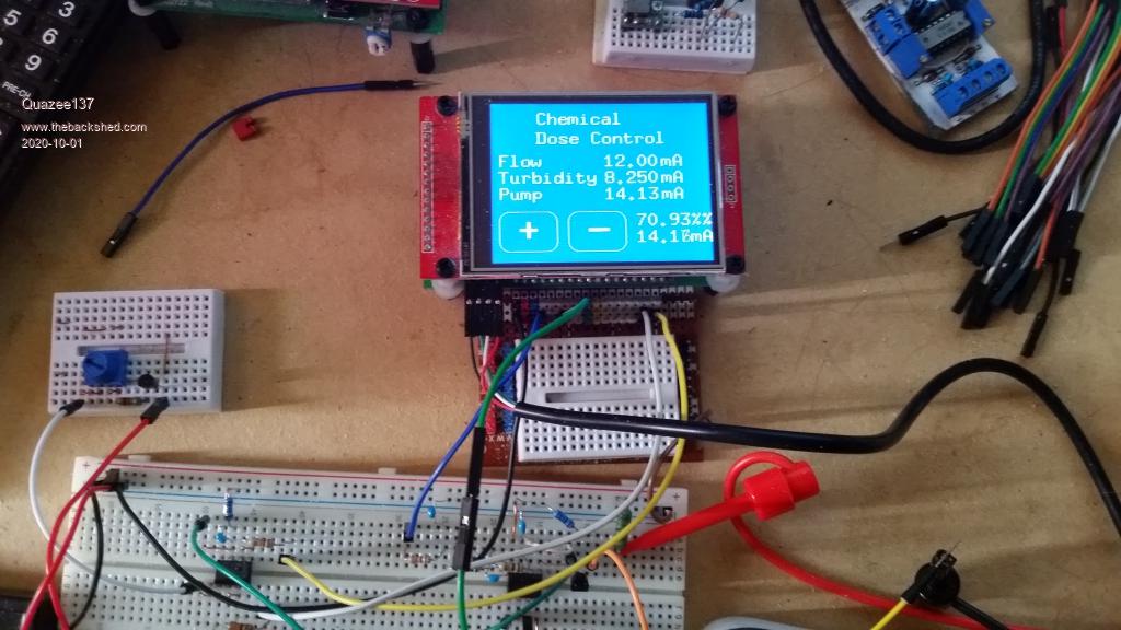

Volhout Thanks

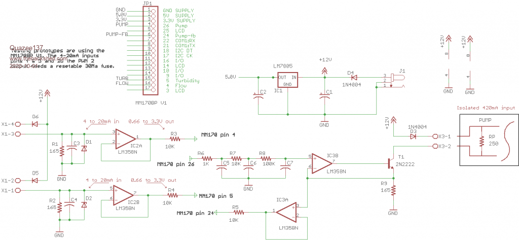

 I have a prototype up and running. I ordered 3.3Volt zeners but they are
not letting the input voltage above 2.4volts.
Here is the latest work
and the testing display
The LM324 / LM358 I have used to read 4-20mA before. Till now did not
have a need to output 4-20mA. Your help has given me more ways to go using
the MM170.
I am using the inputs to index into a table of 2,145 data. The + - touch
buttons are to shift the pump data from the table by a few percentile till
we get enough data and modify the table. Now it is raw F/T to pump lookup.
Having FUN

Quazee137
Joined: 07/08/2016
Posts: 603
Posted: 04:40pm 01 Oct 2020
  THANKS for the MM170 it has become my main go to for my prototypes.
I now get to do in weeks what took months before to do and they like
the fact they get the software listing along with the hardware.
 I put up a logo on the LCD while the array fills. I had used var save
with my test array but the current array is 2,145. Wouldn't you know it
just a tad over.
I am hand wiring three prototypes and while working I started thinking.
 Can the array be filled out and saved in the library like a character set?
So it only needs to be filled once to save time on power up?
If so then testing array(0,0) for non zero I could skip filling the array.

I knew about the zener diodes. Especially the low voltage parts have a very weak cutoff point that starts early. What I normally do is use 1 of those zeners and a pullup resistor to create relatively hard 3.0V. And use 1N4148 diodes (these have low leakage) to clamp inputs agains that 3.0V. Resistor 500 ohm or 1k to +12V.
When do you transfer from the desk to the actual industrial plant ? That is going to be FUN...
b.t.w. I understand what you changed the 150 ohms to 165 ohms at the input circuit to exactly map the ADC onto 0-20mA. I suggest otherwise. I always keep some headroom, so you can detect faults. If the current exceeds 20mA (bad isolation or bad sensor) your ADC will measure 20mA. With 150 ohms you will be able to detect the fault since you would measure 22mA, and see that it is out of range. Similar, if you measure 0mA, there is a wire break.
Edited 2020-10-03 01:39 by Volhout

Posted: 09:01pm 02 Oct 2020
I put 5.1V zeners in for now it should keep the input from going to 12Volts
 The 165 ohms will be ok as they are setting the input flow input max is 12mA
and the turbidity is set to 3.9 to 19.5 for reasons they did not go into.
A few other changes are a bridge rectifier 12 and 5 volt regulators. They have
24VAC and a 15VDC so which ever the hook up to should do.
  At the old house I had all kinds of equipment I could use for testing. Here
I wired up a few LM317 making 0 to 25mA test jigs. For the output I had to dig
out my old multimeters that have 000.000mA display ability where as my newer
ones only have 00.0 on the 20mA setting.
 While the field testing is being done using the MM170BP's. I will work on a PCB
with all the parts and may goto a small I2C Display and a three key touch pad.
I fit an early project with the MM170 and four opto isolators and relay into a
small din-rail case. This is not much more hardware wise other than the 2.8"display.
 With the extra pins I can add alarms or auxiliary controls even use the ESP's
on com ports 1 or 2 for WiFi to browser for phone/computer use. Also getting
around to using the SD-card for data logging.
 So much FUN stuff that can be done with the MITES and MMBasic.
