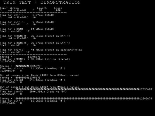

here are my CSUB versions of Ltrim() and Rtrim() for the CMM2.
After all, it's not as versatile as Geoff's useful code example (see manual), but it's significantly faster (~10us).

Demo file and source:
CSUB Trim v1.02.zip

and you can eliminate (almost) any leading (or trailing) characters.
eg a$="0000000012345678", cLtrim(a$,"0"), Print a$ gives you "12345678"
Any feedback appreciated.
