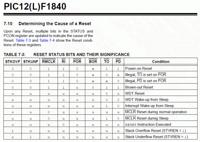

1] Identification of the reset source.
2] True-random number seed.
1 - MMbasic has a dedicated variable to indicate if the reset source was the watchdog, but (at least on the PIC12 devices I've used) the PIC processors also have the ability to give more detail of the reset source.
For the application I wrote it was important to know if the reset was caused by a cold-boot (power on event), or MCLR reset, or watchdog. I think it could identify one other too.
For my use I wanted to know if the device had just been turned on for the first time, or if a power glitch had caused it to restart.
It was easy to do in assembler, but the XC8 compiler needed a little more effort to get it to co-operate. There were a couple of bits (documented) in one of the status registers that XC8 would trash unless specifically told to keep.

I was looking for a little more detail... like what caused the reset. Was it bad programming (watchdog), bad power (brownout), loss of power (POR), hard reset (MCLR) or soft reset (RESET instruction)...
Mind you, I don't know if these are supported by the PIC32, but being a significantly more capable chip, they probably are. I can understand it, but not having a single datasheet for the PIC32MX chips makes it very difficult (time consuming) to find out even simple information.
Cheers,
UPDATE: I found the relevant PIC32 data sheet - couldn't find it on the Microchip site, had to google it! Pretty poor reflection on the manufacturer. Different register names and bit interpretations, but everything can be ascertained.

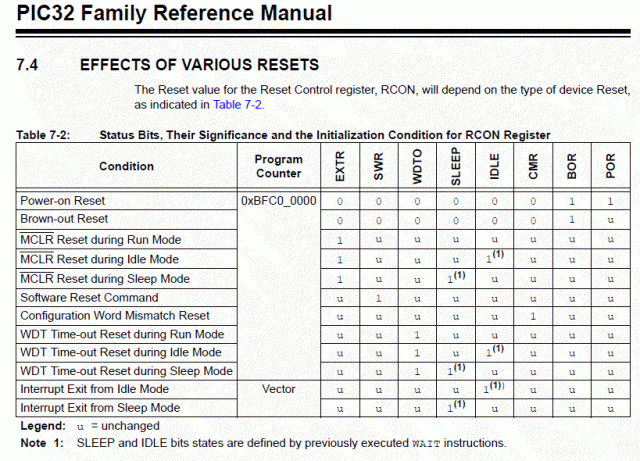

Posts: 3370
Posted: 07:56am 10 Sep 2020
You can always use PEEK to examine the reset register (RCON).
As follows: status% = PEEK(WORD &HBF80F600)
The bits are described in the PIC32 MX170 or MX470 data sheet.  Look for the section headed "RCON: RESET CONTROL REGISTER".  This is a summary:
bit 7 EXTR: External Reset (MCLR) Pin Flag
1 = Master Clear (pin) Reset has occurred
0 = Master Clear (pin) Reset has not occurred
bit 6 SWR: Software Reset Flag bit
1 = Software Reset was executed
0 = Software Reset as not executed
bit 4 WDTO: Watchdog Timer Time-out Flag bit
1 = WDT Time-out has occurred
0 = WDT Time-out has not occurred
bit 1 BOR: Brown-out Reset Flag bit
1 = Brown-out Reset has occurred
0 = Brown-out Reset has not occurred
bit 0 POR: Power-on Reset Flag bit
1 = Power-on Reset has occurred
0 = Power-on Reset has not occurred
Note that MMBasic maintains its own watchdog timer and uses a Software Reset if it has expired,
