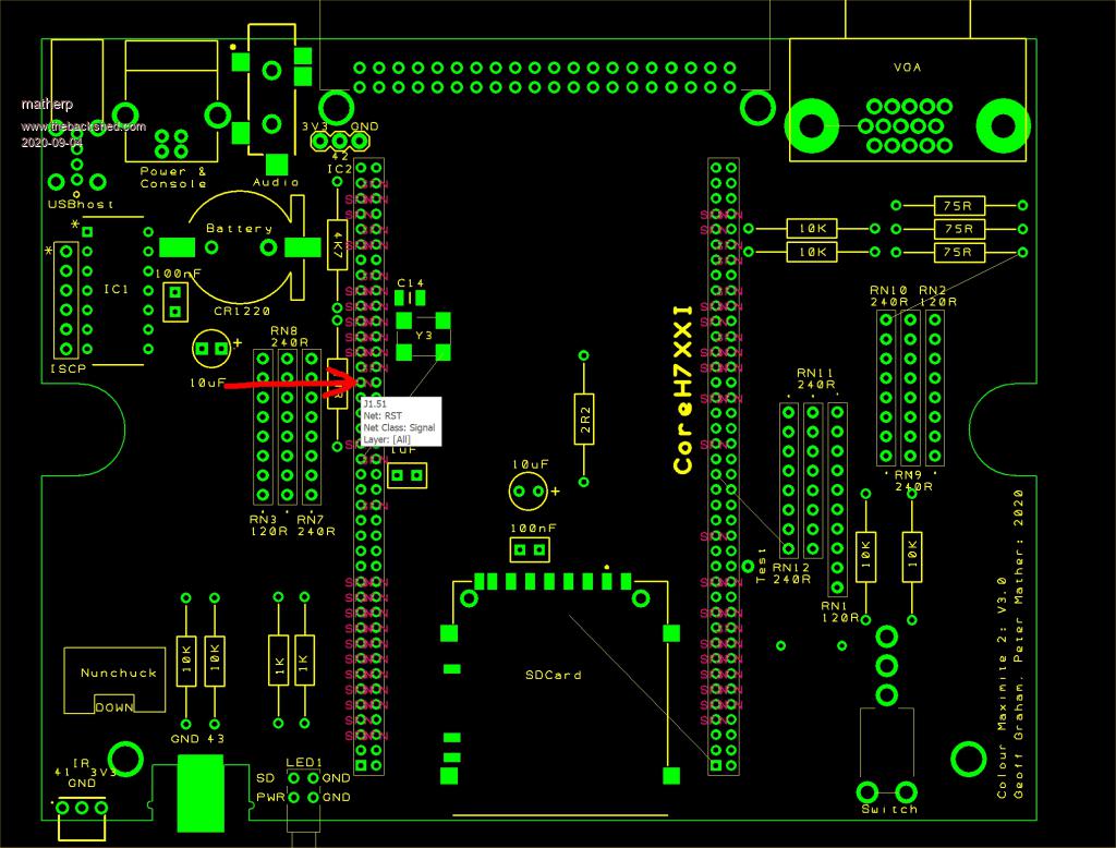

Posted: 07:52am 04 Sep 2020
Connect between the reset pin on the 80-pin header and GND
Edited 2020-09-04 18:03 by matherp
Posted: 09:50am 04 Sep 2020
  matherp said  Connect between the reset pin on the 80-pin header and GND
Thank you Peter, looks like there is something a "bit" more substantial to solder onto there.

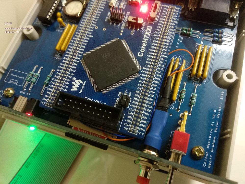

I've found the Waveshare is not as difficult to remove as I feared, so once I've checked that the reset works I'm just going to solder the leads to the underside of the JTAG.
Posted: 03:24pm 09 Sep 2020
Despite my ample lack of talent I don't appear to have cocked it up, thanks for the advice folks.
Note that the green glow from underneath is the far too bright ready LED of my original CMM that the CMM2 is sitting on.

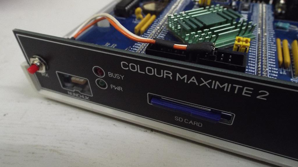

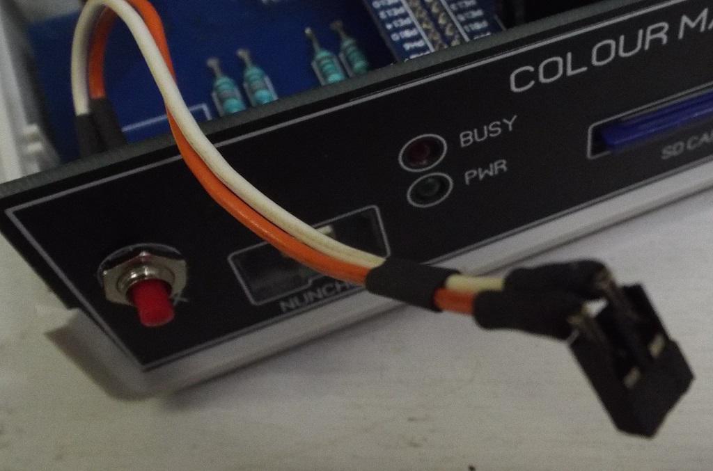

Edit:Cut Down an old PC Reset Switch 2pin DuPont housing, bent the cripmed ends, and insulated them with heatshrink tube.
This will then fit into the JTAG connector on the Wavesharre board, without fouling on the case.
Its a tight squeeze, and you may ruin a few crimps to get it right.
Soldered on a small push to make switch from my parts box and fitted it in the IRX hole in the front panel.
The Case Lid Fits - just
Edited 2020-09-24 04:12 by Womble

Posted: 06:17pm 23 Sep 2020
Reset Mod complete, see post above.
Managed to do this in an non-destructive way
