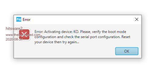

Thought maybe I could revive it with Windows , but :
Edited 2020-08-31 11:23 by hitsware2

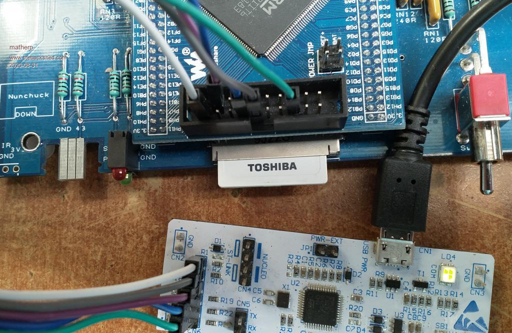

If you or anyone you know has access to any of the ST Nucleo boards you can cross link the ST-LINK header to the Waveshare board and use ST-LInk to re-program
Edited 2020-08-31 19:22 by matherp
