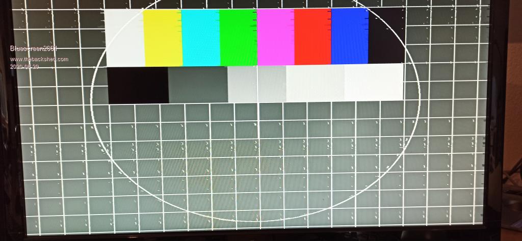

Hi,
yesterday arrived my new Color Maximite 2. I noticed some slight flickering in the status line and especially in the inverse status line of the editor. In black screen areas this is not visible.
So I wrote a small program that creates a gray screen with a white grid on it. After drawing the image the program simply exits and stands there with the BASIC prompt visible beneath the drawed image.
There I see the the flickering all over the screen. It is not continously but every few seconds there is here and there on the screen some flickering visible. Also there are times where there is no flickering. It seems to somehow periodically.
I tried several monitors and always pressed the adjust function of the monitor.
But it looks not like sync failures of the monitor. The displayed grid is stable, but here and there appeared some colored little squares. I know such distortions from an ages old Z80 computer where it appears when the CPU writes to the framebuffer, because the CPU had priority over video controller. I also tried several power supplies.
So maybe there is some timing problem with the video DMA accessing the RAM. Maybe some software activities in the background which disturbes DMA.
Is that a known problem, or a speciality of my CMM2. It is the original board with the waveshare CPU board on it.

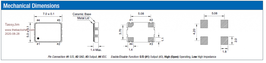

From the construction notes:
  Quote  The latest PCB has provision for an external 8 MHz crystal oscillator to replace the 8 MHz crystal on the
Waveshare CPU board. This may be needed in some rare cases where a monitor has difficulty with some VGA
modes (such as 800x600 pixel 16-bit colour).
Most people will not need this mod however, if it is required, it can be implemented by removing the 8 MHz
crystal on the Waveshare CPU board and installing the external oscillator and a capacitor on the motherboard.
The parts required are:
1 SMD 1206 100nF ceramic capacitor
1 8MHz oscillator in 5.0 x 7.0 mm SMD package (QX7 XO 25ppm). Eg, RS Stock Nbr 813-6194 .
I mounted mine dead bug style on the Waveshare module but current mainboards have provision for it there which is much neater.
Edited 2020-08-28 07:48 by TassyJim

Since I have no oscillator on hand, I first tried to change the crystal and both of it's capacitors. But that didn't help.
This is mode 9:
In the default mode the flickering is only ocassionally, so I can live with it for now.
I have to wait until I have a few more parts to order. 0,90€ plus 6€ shipping is too unefficient.

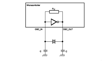

Posted: 04:43pm 08 Sep 2020
the problem is not the crystal itself, but the nature of the circuitry (within the H7 processor) that drives it:
while the OSC_OUT pin is a low-impedance output, the OSC_IN pin is a high-impedance input. on the waveshare module this pin is not only attached to the crystal, but also runs to a pin on the edge of the module's PCB. this acts like a little antenna that picks up signals from other traces that run near to it on the module. in particular, traces that have high-speed clock signals for the RAM chip located on the underside of the module.
the signals that are picked up by the 'antenna' attached to the OSC_IN pin interfere with the smooth/stable running of the crystal oscillator circuitry, randomly trying to pull the oscillator off-frequency ever so slightly, resulting in tiny glitches in the VGA output.
the folks who designed the waveshare module really should have considered this, and employed a better layout to avoid the possibility of having stray signals coupled into the OSC_IN pin.
when you add an external crystal module, this provides a low-impedance output that drives into the OSC_IN pin on the processor. because the source is low-impedance, signals from nearby traces are no longer able to interfere.
rob   :-)
