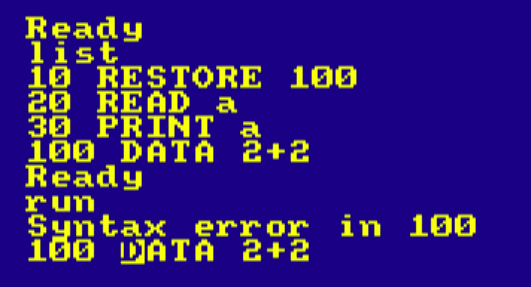

Posted: 12:17pm 26 Aug 2020
so I get to thinking... it makes sense that elements of DATA are evaluated, otherwise how could we have stuff like &B1111011 etc...?
Then I think... Have I been missing this all the time?
By going back to the earliest proper programming job I had (embedded CPCs in radar systems) which uses Mallard Basic (and later the "same" on PCs) I have salved my worried brow that I was as totally ignorant as I had recently come to believe.
thank god for that!
