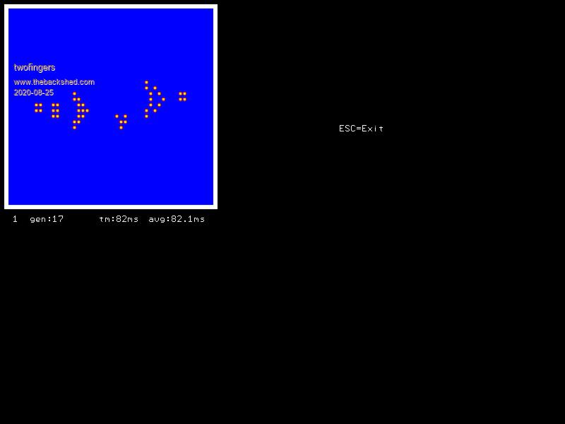

Six years ago I wrote "The Game of Life" for Maximites.
This is the upgraded version of John Conway's GOL for the CMM2. Improvements: graphics, speed and menu for the demos. An editor is planned.
It is fast:
To complete a small world (1000 cells) it needs ~50ms.

Looks Good!!!  And it is Fast!  There be Gliders and Guns!
You might want to set the graphics mode to 1,8 although the Small and Med playing fields also look nice in Mode 2,8

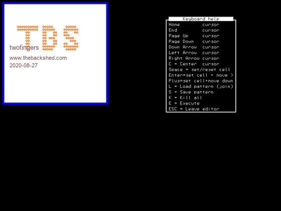

This ist the new version with an included editor. I think it's cool.
Life 202.zip
Included are some ".gol" files please rename to "LIFE.GOL"
Best regards
Michael

looks like maybe you accidentally left a save image test in the load function?
-Carl
twofingers
Joined: 02/06/2014
Posts: 1784
Posted: 11:27am 27 Aug 2020
  Sasquatch said  looks like maybe you accidentally left a save image test in the load function?
Hi Carl,
you are absolutely right again! Took a picture for the forum and forgot to remove the inserted code. It seems I'm too old for the Game of Life!
Thank you!

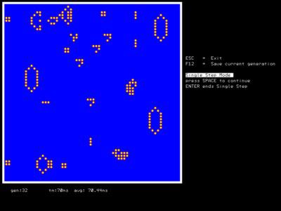

EDIT 27.09.2020:
The latest version has nine slots for storing GOL files, a single step mode, additional GOL files, an auto save mode, improved speed and more.
I included epsilons very useful MAR archive program (v0.3). Many thanks for that!

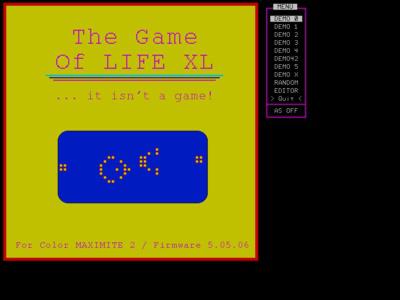

This is the new XL version. It is working with MMBasic >=V5.05.04 but especially for MMBasic V5.05.06 and later. With MMBasic V5.05.06 it is now very fast (8 times than the older version). I had to include a brake.
Livex 35.zip
Enjoy!
