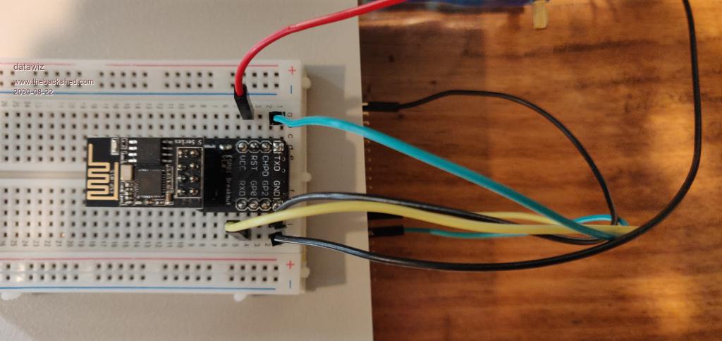

In regards to the hardware I'm using and how it is wired up--
I had some ESP-01 units (non-S) but had problems getting them working on the CMM2, even though they worked on my PC via a USB adapter. I may go back and revisit those units, but since the ESP-01S units worked without any issues, I moved forward with those.
ESP-01S on Amazon
I used these breakout boards to make them breadboard friendly:
ESP-01S breakout board on Amazon

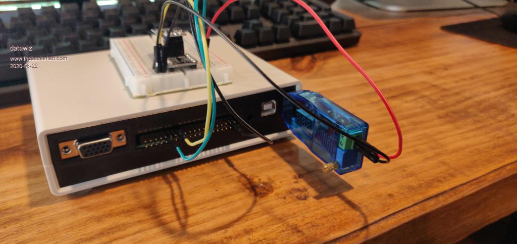

The ESP-01S won't power from the GPIO pins, so I used these usb voltage regulators to give it the 3.3v it needs. I used the on-board USB port and an external power supply and both worked fine.
USB adjustable voltage regulator on Amazon
Here are some images of how it is wired up:

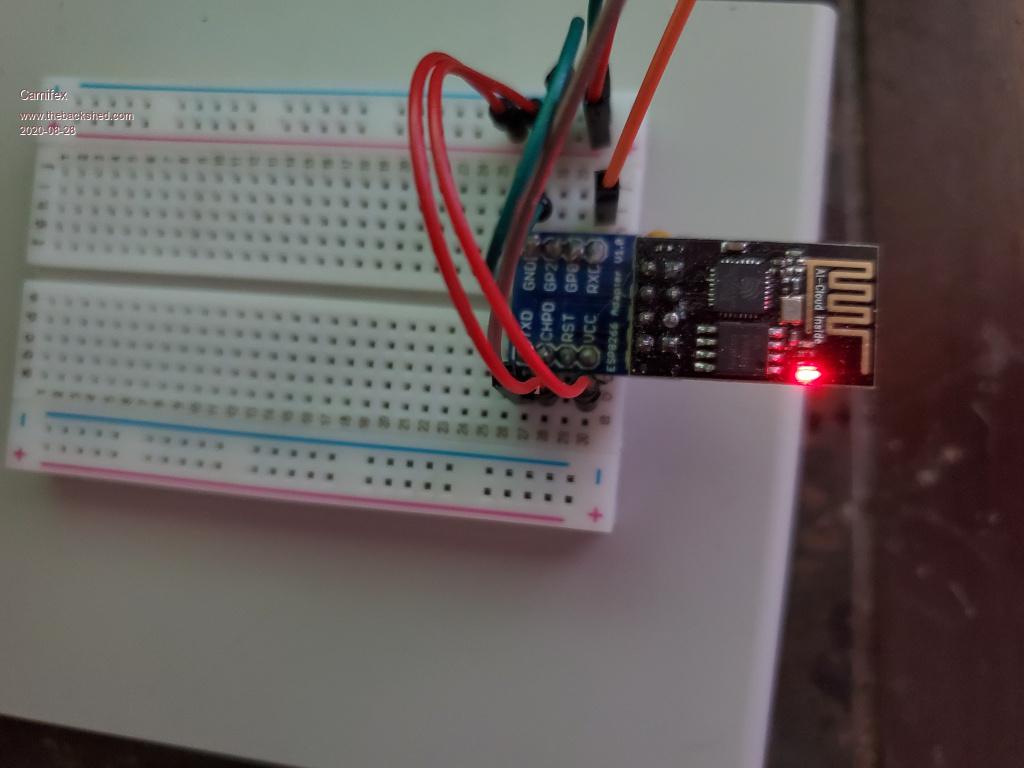

From your code, I assume you are using COM2, I wired mine to COM1. The only other thing I can think of is perhaps I have have an older version esp.

I'm powering using THIS puny USB Power Regulator from Amazon, so your bench power supply will be more than suitable for the job. I power it using a generic external USB charging device plugged into "mains" (thats how you Brits say it, right?) power. :-)
I tie grounds from the CMM2 GPIO pin together to the ESP8266 pin and the power supply ground, if I didn't do this, i was unable to read data from the serial connection.
