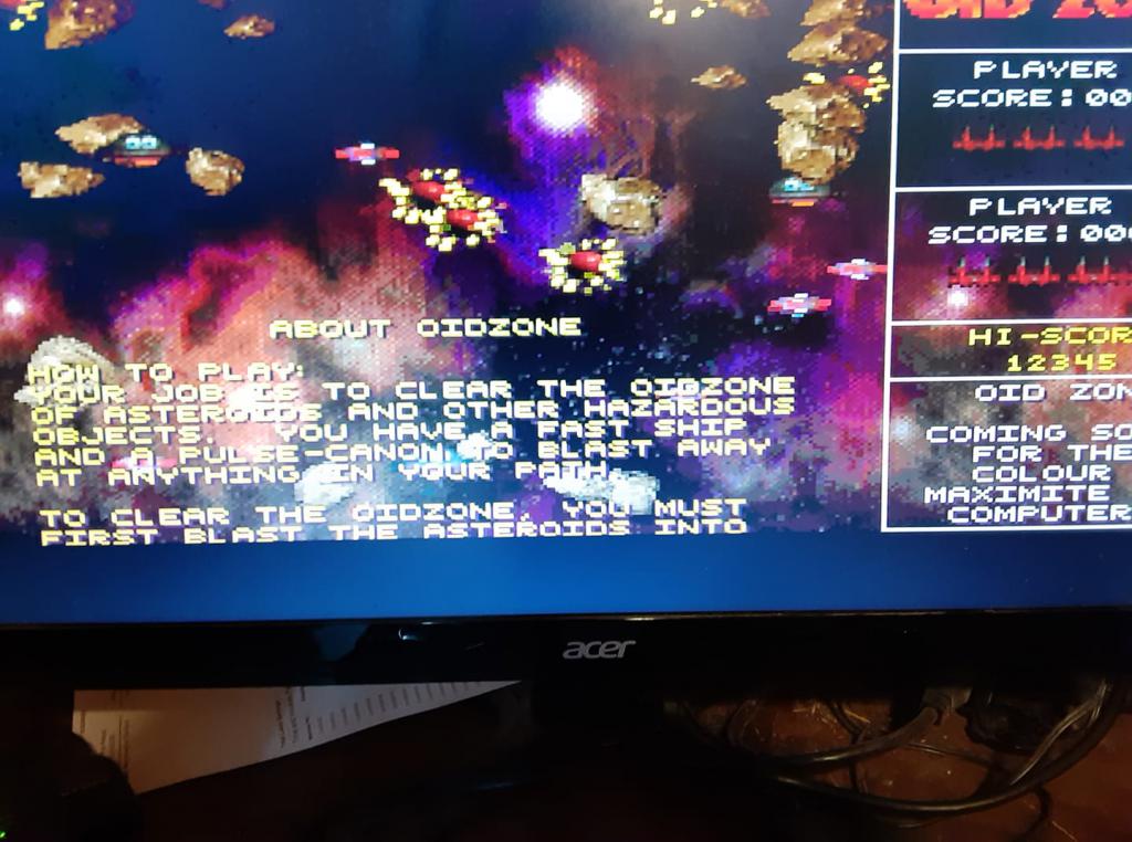

You gave me an idea to scroll text over the asteroids and whatall in the game I'm working on, OidZone.  I was overlaying text on top of the frame before but now I scroll the text onscreen and up to it's position
YouTube Link to video of scrolling text
I pre-draw the text on page 23 (in mode 3,8) Then to scroll it on screen I use the frame counter to control the scroll it from frame 200 to frame 390 and then hold it after frame 390
if j>200 and j<390 then
blit 0,0,0,400-j,320,j-200,23,&b100
else if j=> 350 then
blit 0,0,0,10,320,190,23,&b100
end if: end if
so it copies the data from 0,0 width 320 height from 1 to 190 increasing each frame to frame 390, to in this case page 8 at 0,400-j so 199 to 10 going up to line 10.  The &b100 masks out the masking color on the blit. I'm using my own font and font draw  code.
