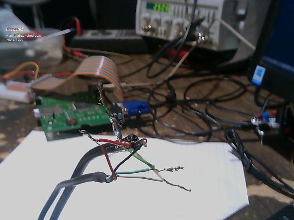

Yea ..... I ' ve got a kazillion USB cables ,
and not 1 A to A
my site
Posts: 6216
Posted: 06:10am 21 Aug 2020
Since CMM2 is new, comming month SW updates may be coming, so prepare for a decent solution. Very logical is:
For an A-A cable, take 2 out of the Kazillion cables and cut the non-A part off.
On both A pieces solder wire to wire. Typically the wires are color coded. Solder same color together.
For Aussies and Brits:
Typically the wires are colour coded. Solder same colour together.
Or - you order from Ali or Ebay...

I got mine from an electronics shop. I also wondered about soldering an additional socket, USB micro-B or C, to the board, but that would require some more consideration.

Posted: 06:43pm 21 Aug 2020
Technology Marches On !
Good idea , but still no cigar ( back to Windows this time around )
my site

Posted: 02:24am 22 Aug 2020
  hitsware2 said  Ordered a couple of these
I think I may be missing something besides hardware though
Yeah, unless there's something wrong with your homemade cable I would think it should work like a bought one.

Posted: 03:52am 22 Aug 2020
We ' ll see .
I may just be in over my head .
( Wouldn ' t be the first time )
Edited 2020-08-22 13:53 by hitsware2

>>UPDATE FIRMWARE
Then unplug keyboard and plug into RPi ....
My home brew wire evidently didn't work ...
Maybe Tx and Rx need to be crossed as with
some serial connections ?
