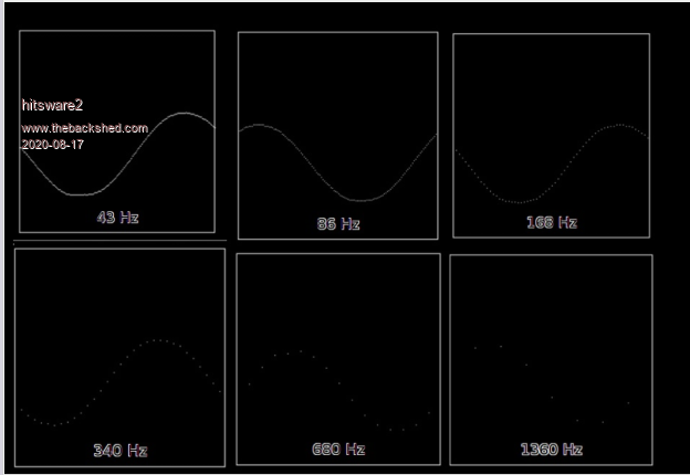

' "oscope"
'mode 1,12
setpin 7, ain,8
'page write 0
'box 400,150,260,250
'page write 1
'do
cls
for x% =400 to 655 step 32
y%=275+((1.5-pin(7))*100)
pixel x%,y%
next x%
'loop
box 400,150,255,265
save image "1360 Hz",390,140,275,285
end

If you use the PIN function to read an analogue value, sure. Take all the calculations and screen drawing out of the loop and it will go lots faster.
To go faster still, look at the ADC commands that can fill a DIM'ed array at 100+ times the frequency.
I ' m trying for ' real time ' so needs be ( I think )
the screen drawing .
Yes .... I tried that this afternoon . Definitely faster ,
even doing the screen drawing while filling the array .
And has the triggering !
BUT ....
Seems to lack some accuracy ?
