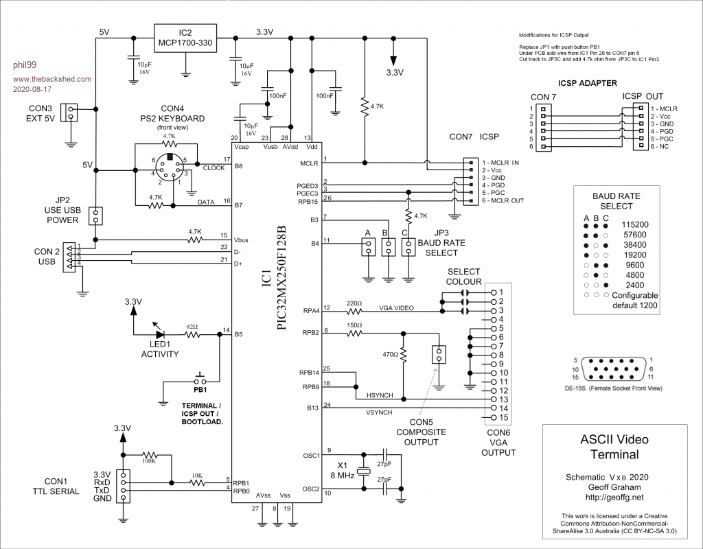

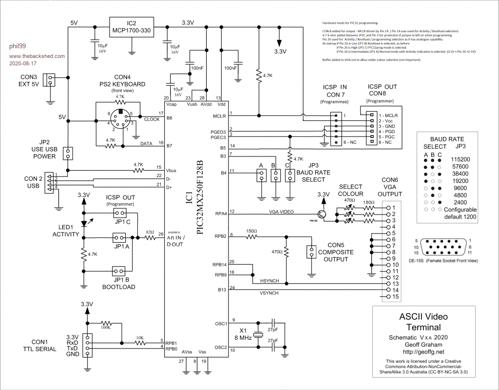

A project suggestion - update the ASCII Video Terminal by Geoff Graham With ICSP Output and it would become a Swiss Army Knife for Micromites. It could also be built into a Micromite LCD backpack in place of the microbridge to make a stretched version. A micro maximite or maxi micromite?
Below are two suggestions for the hardware but the real work is in the C programming which is beyond me.
Hopefully there is room for the extra code, Peter Mather's CFunction in Pic32prog.BAS (from MM Flash) is 6 to 7 KB so I guess it will be at least that much extra. As the Pic32prog.BAS CFunction works in PIC32MX chips it may be a good starting point for the project.
A - For a choice of 3 modes without using extra pins an analogue input is needed. The present mode select pin (14) is I think, digital only, so the Mode select pin is changed from 14 to 26 (the only spare pin).
Pin 14 now used for MCLR output. PGD and PGC input pins reused for PGD and PGC output in "ICSP Out" mode.
To protect pin 3 of the IC during output, the track to JP3C has a 4.7k resistor in series. Relying rembering to remove the jumper before programming is risky.
B - Another way is a push-button replacing the pin 14 "bootload" jumper JP1 to cycle through the options, as per microbridge, with the LED blink rate or blink pattern indicating status. Pin 26 used for MCLR output.
If the "bootload" mode can only be initiated at startup it will be necessary hold the button down while powering up.
The extra hardware for this method is so simple the same PCB can be used.
IC1 Pin 26 is routed to unused pin 6 of the ICSP header, with a short adapter lead for ICSP output. At the input socket end of the adapter pin 1 is left empty and pin 6 is routed to pin 1 at the output socket end. Pins 2 to 5 go one to one. To protect pin 3 of the IC during output, cut the track to JP3C and solder a 4.7k resistor from JP3C to IC1 pin 3. Relying rembering to remove the jumper before programming is risky.
I can email circuit diagrams if anyone wants to have a go at it.

Circuit diagrams for above
