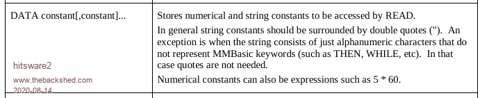

One mistake you have made is in the DATA statements.
You should surround string data in quotes.
Otherwise MMBasic get confused with variables.
