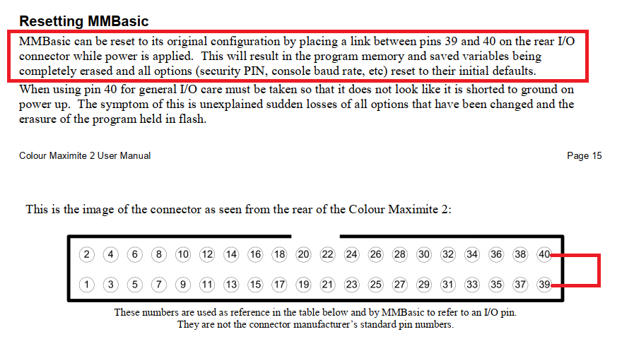

The manual as of 5.05.05b7 states:
I was expecting the CMM2 to be reset to its "original configuration" as stated, and that when I power cycled the machine with pin40 pulled to ground (I used a motherboard jumper across pins 39 & 40) the initial setup program would run, allowing me to select keyboard type, and to set the date and time.

I have also observed that the last program run displayed on the status bar is cleared, and assume that any other options/settings that I may have changed will have been reset too.
I'm not seeing the initial "setup" program ...  is that normal?

Posted: 02:08am 13 Aug 2020
Shorting pin 40 to ground will clear all saved options.
It will not re-run the first run setup. That is normal.
The saved options share the backup battery with the RTC which is why removing the battery also resets the options.
