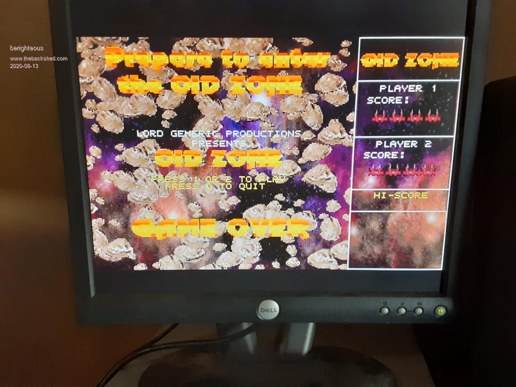

Hey all!  Here's a teaser for a something I'm working on
I have 300 animated asteroids in various sizes with animated overlays. I'm not using sprites. I have control arrays for any number of objects and I'm blitting them to the framebuffer. I set the framebuffer to 50 pixels larger than the playfield size all the way around, so that as the asteroids move off the playfield I can neatly crop them out by blittting just the playfield region.  Every frame I restore the framebuffer and background then blit a bajillion asteroids, then blit the playfield area of the framebuffer to page 9 where I add the overlays and the feedback window to the screen before page copying to page 0.

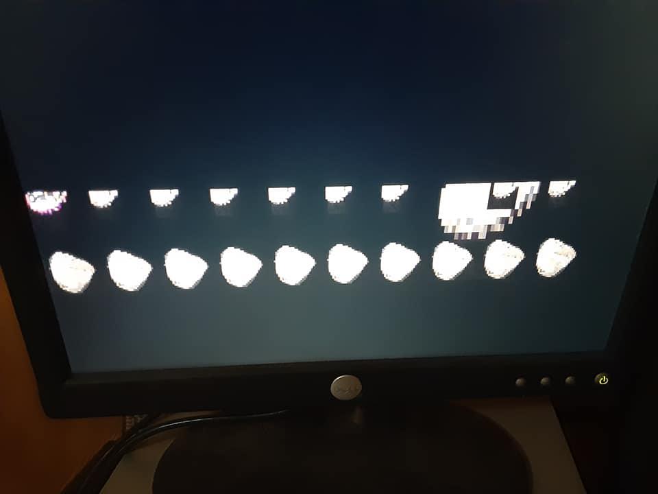

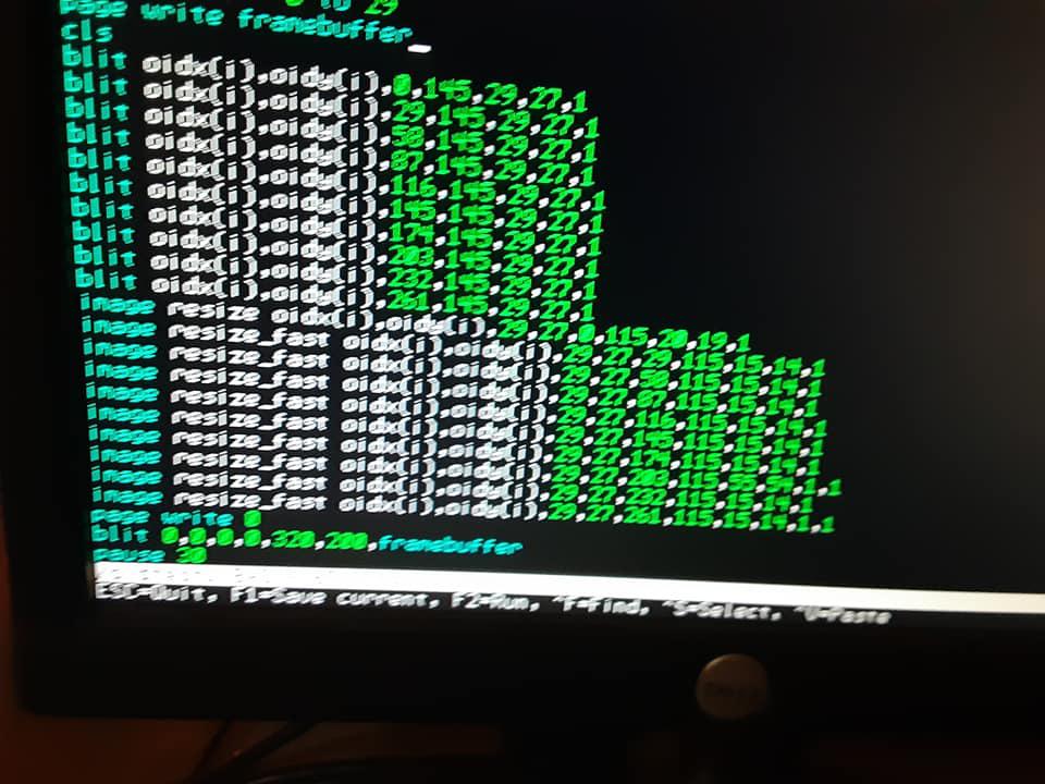

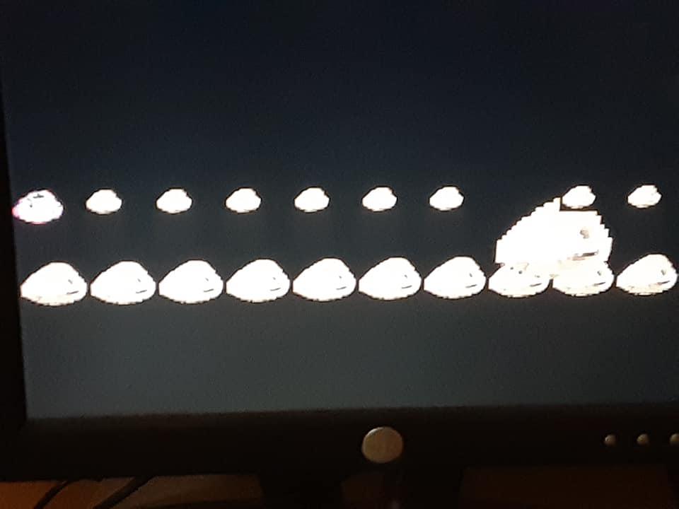

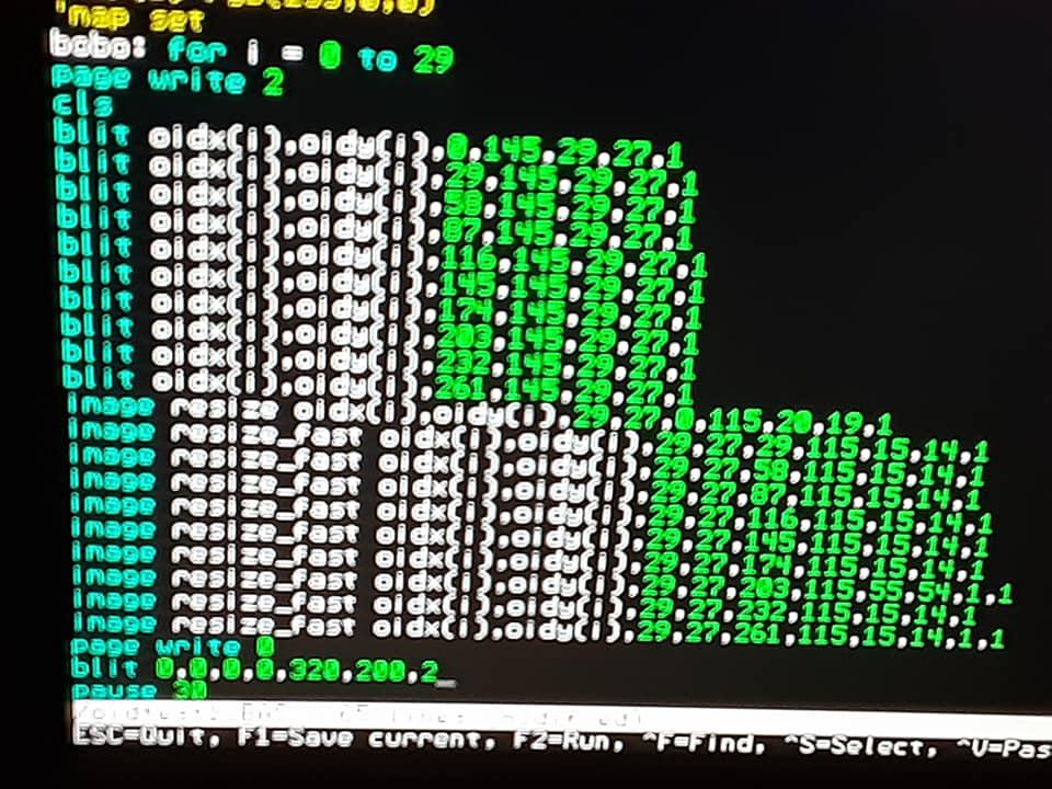

Will do.  I had it write to a 320x200 frame buffer and blit back to Page 0 and the sprites were garbled, and when I changed it to write to page 2 and back they were fine.
Here's the code (phone camera sucks, sorry) blitting and image resize_fast to page two and blitting back to 0.
resizing works fine.  I'm using a custom palette, so regular image resize mangles the colors.  Image Resize_fast works fine with nearest neighbor scaling or whatever it's doing.
here's the code for using the framebuffer.  I opened a 320x200 frame buffer.  The onnly change in the code is page write framebuffer and blitting final image from framebuffer.  All the resized asteroids are cut in half and they "bounce" up and down and don't stay in the same place vertically onscreen
Here's a youtube link showing what it's doing
Edited 2020-08-13 19:16 by berighteous
Posts: 12093
Posted: 09:24am 13 Aug 2020
What colour depth are you using: mode 3,?
