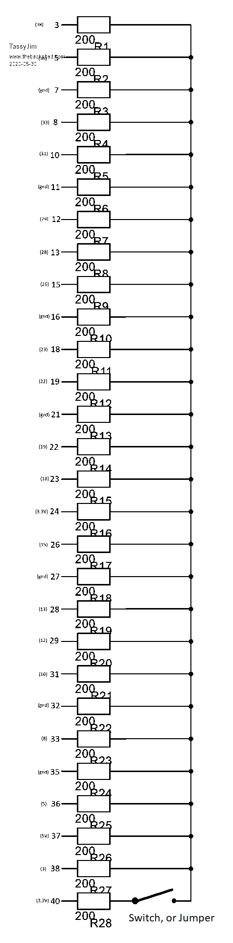

This inspired me to break out the "Stripboard" and test the 40way IO connector on my CMM2 v3 Kit.  Rummaging in my leftover components store I came up with twenty eight 1.2K 2% resistors and the other components required to build this tester.
I used this schematic:
Modified from Jim's original to include the recommended switch.
  TassyJim said  The pull-up used during boot to initiate a reset is not strong enough to handle the load my tester puts on it.
When the pin tester is plugged, it keeps pin 40 low during the boot sequence.
When you change some options such as keyboard, the system does a reboot and if my tester is plugged in, you loose all settings.
If that's a problem, you could put a switch on pin 40 and only close it during testing.

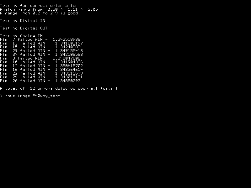

produced this output:
I assume this portion of the program produces the errors:

I am getting an analog reading for V of around 1.34 - 1.35 (volts), which flags as an error.
Is this because I am uisng 1.2K resistors ?
As mentioned elsewhere on the forum I had some problems with my CMM2 build, so it may be that I have some poor solder joints, or have damaged my board with all the rework carried out during the troubleshooting.
I find it interesting that the errors only occur with the Analog Inputs, all 12 of them.  Makes me suspect my 40way IO connector  might be fine, and my resistors are too high a value.
Thoughts please, Thanks

  bigmik said  I would be curious as to your result by removing the REMs that I marked in RED on the above listing.
No problem.  Here is the amended program I used, and the test results:
CMM2_40way_Test.zip
adjust the commented out code to suit.
BigMik's amendment, setting pins to DIN (as shown in red in previous post)
TassyJim's amendment, adjusting the voltage range deemed acceptable (1.25v - 1.9v)
Both the amendments:
