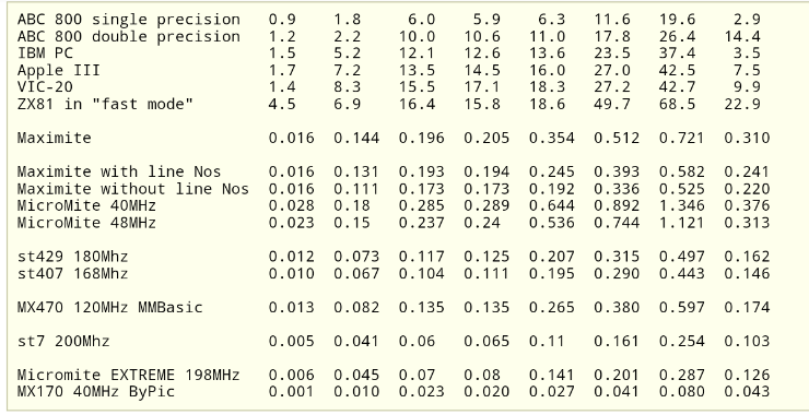

I am delighted with the performance of the MX470 based E-100 that I have implemented as a host controller for my CNC system but for my production design, I prefer to go "distributed" by using multiple MX170s. I just love the simplicity of this solution.
However, I am a bit concerned about execution speed in certain applications and so, rather than resort to C coding, I will simply load-up that/those particular devices with Bypic.
Bypic is no longer being developed but hey, it works and it is also interactive. In fact, it can be more interactive than MMBASIC if one decides to use multi-tasking because the command prompt is always available whilst the program is executing.
Code is on page 3 of this thread
