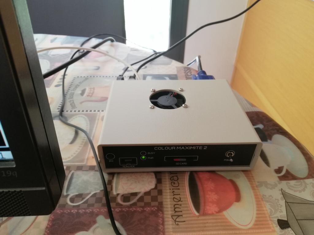

Hi!
I add a fan to my CMM2 case.
Connected to pin 40 and ground.
I start / stop with software
Not a very necessary.... just for fun!!!
My normal working temperature are 50~52 C
When I start the fan, down to 47 C.

Pin 40 is used to reset the options and clear memory if pulled low on boot. Your wiring may be pulling pin 40 low through the coil on the fan. Suggest you use any other pin.

  matherp said  Pin 40 is used to reset the options and clear memory if pulled low on boot. Your wiring may be pulling pin 40 low through the coil on the fan. Suggest you use any other pin.
Oki Doki... moving to another pin!

I hope you have some kind of driver on that fan and are not just directly connected to the I/O pin.
Cute addition, but the CMM2 does not require active cooling, or even passive cooling, so I am trying to understand WHY you did it.  Is it just to make it look cool?
