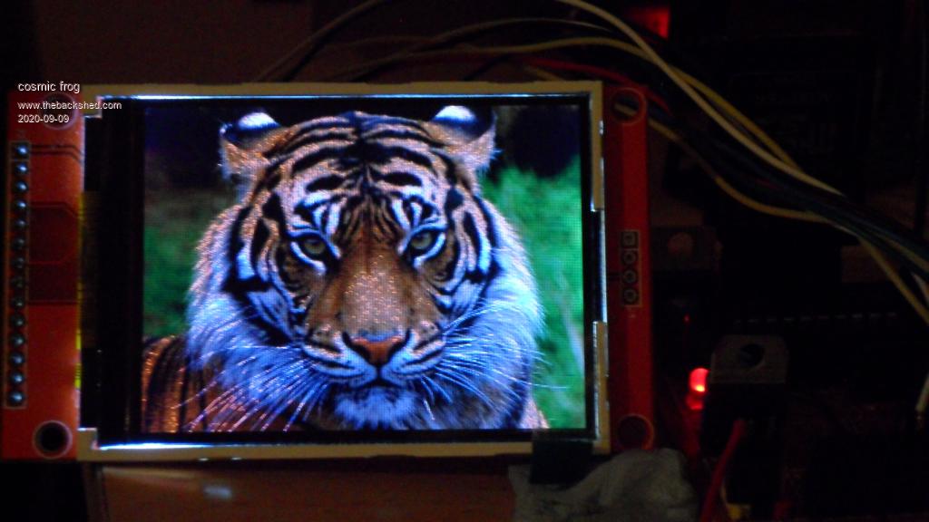

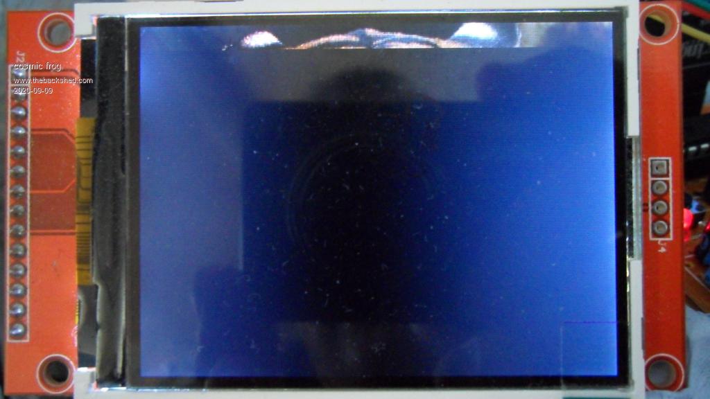

Hi.
I used to use some code written by matherp to display pictures in .ppm format on a ILI9341 LCD panel using an sd card. This code no longer works with the latest firmware for the 28 pin Micromite.
Matherp has released an update but I cannot seem to get it to display .ppm pictures.
Everything else seems to work great.
Any ideas?
Thanks.
Dave.

This is the BASIC code I'm using.
option explicit
option default none
' Version to use the standard SPI port on the Micromite
const mount=0
const fileopen=1
const readfile=2
const writefile=3
const opendir=4
const readdir=5
const CS_PIN=15 'Chip select pin conected to the SD card
cls
displaypicture("tiger2.ppm",0,0)
end

Still Having problems with this.
Everything works great, it just will not show a picture.
just gives an error.
Error : SDCARD is not declared.
I've spent weeks and weeks on this, and every bit of spare time I have.
I've tried older firmware versions and the best I got was a few lines of the tiger pic along the top of the screen.
I may have to give up on this one.

Installed the latest firmware v.5.05.03 and using 2016-04-01_152624_newpic.zip
gives me this on the screen -
cosmic frog
Joined: 09/02/2012
Posts: 311
Posted: 09:00pm 08 Sep 2020
Finally got it working!
Turns out it was the SD card
I was using an old 1gig card, changed it for a new 32gig and it worked first time
Dave.
