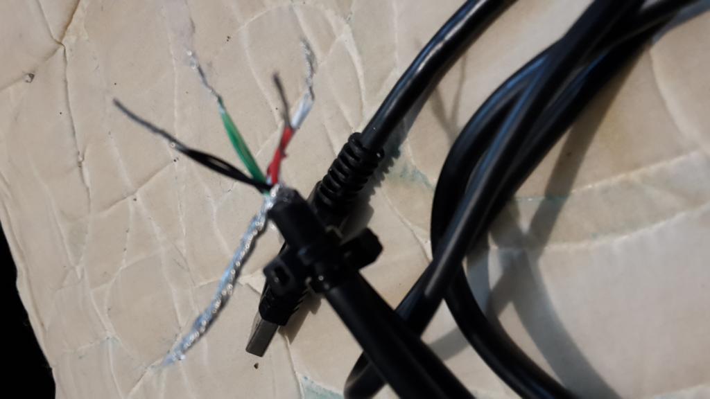

I "made" one from 2 A-B cables (obviously not "finished")
