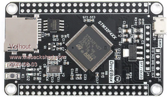

Smaller F4 board
There is no LCD interface, the RTC battery must be wired external.
The 44 pin headers have the IO pins arranged identical to the board I am using now, but the power pins are at different location.
I have ordered one, and will test if MMBasic runs on it.
P.S. haven't found schematics yet, so not sure it works...

Today I received my smaller STM32F407VET6 board (the DevEbox board).
With a jumper I connected J1 pin 1 and 2 and got the board to boot in DFU mode.
Witch the Cube programmer, I could write the ArmmiteF4.bin file, it programmed, and verified OK.
Then I removed the jumper, and ....nada....nothing.
It did not enumerate on my windows machine (same as my 'defective' Armmite F4 board).
Then I tried the first version Peter made (that one ran on my earlier defective board...it ran..kind of). Nada.
Tried a linux machine, and with 'lsusb' noticed it did not enumerate at all.
So I am out of luck.
It is either defective, similar to the old one.
Or it does not boot Peter's code because it does not have the LCD wiring on this board.
1- I will do an extra check on the schematics, to see if there is some wiring difference that may be critical.
2- I will (when time permits) to see if I can build micropython (there is a custom version for this DevEbox board) and check it that boots.
3- I may try the version with serial port, and see if that one works.
Not sure what to try first...maybe 3-
Worst case, there is $6,00 down the drain....

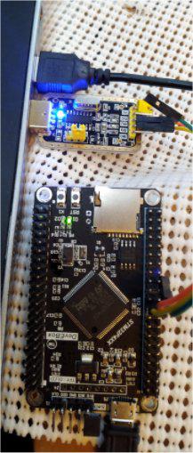

I flashed my second one of these with the serial console version. Works fine. I soldered two pins to a CR1220 battery holder and a 2-pin socket to B1, and the built-in RTC works.
I had previously made a PCB to break out the F4 pins. There were no traces from one side to the other, so I just cut the center out of a blank one, soldered connectors, and plugged them in. As Volhout had noted, the pins are (almost) the same except that the power pins have been moved to the opposite end of the rows (and VR- and VR+ have gone away, but my PCB didn't use anything below them anyway). I used flying leads to provide 3V3 and 0V to where my board expected them.
Now I have serial console out from my PCB, 6 DS18B20s being read on 1,4,5,16,17,18, and 4 LEDs flashing on 95,96,97,98.
I'm afraid to try the ILI9341 again even though I won't repeat exactly what I did the first time (and I think I have a better idea of how to define the pins). What I did produced an error when I tried OPTION LCDPANEL DISABLE, but I still had the ">" prompt. When I reflashed, I couldn't get the prompt back.

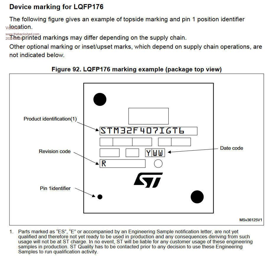

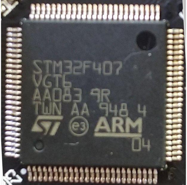

Is there a date code on the chip ? Maybe these cheap chinees boards are manufactured using a batch ST dumped ?
Posted: 03:17pm 27 Aug 2020
Here's what the chip looks like, but I don't know what it might tell me:
Posted: 05:58pm 27 Aug 2020
Ouch - that's a VGT i.e. STM32F407VGT6 but the Armmite is for the VET6.
Er, I haven't looked the differences up!
Edited 2020-08-28 03:59 by JohnS
Posts: 12084
Posted: 06:19pm 27 Aug 2020

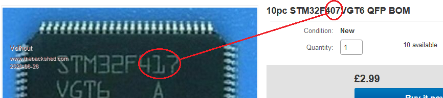

VG version is fine - just twice the FLASH. However there is something very suspicious about the pricing of these chips. Check this out and compare with a unit price of $10.51 from ST direct in volumes up to 500. The pricing of the VET board seems more possible - cheaper chip on a board that sells for more and made in huge volumes
Edited 2020-08-28 04:20 by matherp
Posted: 06:30pm 27 Aug 2020
  matherp said  Check this out
Interesting. 10 for 3 Pounds. But how does the F4 board we have been using sell for $9 if the STM32F4VET6 chip sells for over $10?
It's too bad this doesn't "just work"--it's nice and compact, and aside from the issue with USB enumeration and possibly re-flashing, it seems to function with everything I've tried.
Posted: 06:39pm 27 Aug 2020
I think the CPUs are what were left after some production run.
But they could be ones that failed some ST tests and then got smuggled out.
(Add your own theory...)
