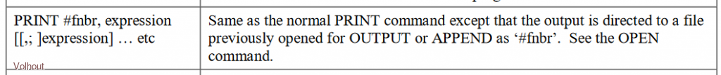

1/ According to the manual I should be able to write multiple variables in one print statement. I cannot get it to work.
I tried all options (variables separated by space, comma, semicolumn, combinations), see below program, but none seem to work except individual writes (print #). By the way, this problem also exists for individual reads (input #).

I got bitten by a version of this 2 days ago. INPUT wants its variables to be comma-separated.
My problem was that I had commas in the text data I was trying to read. It's not in the manual, but the solution is to enclose text which includes commas in quotes: "Now, it works"
This gives what you're looking for with comma-separated numbers:
Sub write5commaSep
Open "AA" For output As #1
Print #1,a;",";b;",";c;",";,d;",";e
Close #1
Then you can read back with: Input #1,a,b,c,d,e
