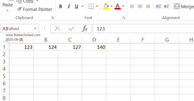

Hi IanT,
It is very simple to create csv files from MMbasic for DOS.
You have to write data in readable ASCII form, with comma's in between.
Example
Open "test.csv" For output As #1
a = 123
b = 124
c = 127
d = 140
Print #1, Str$(a);",";Str$(b);",";Str$(c);",";Str$(d)
Close #1
End
In Windows you will see a file named "test.csv" appear.
Clicking on it will open Excel
If you want the data in different rows, you have to use different print statements
a = 123
b = 124
c = 127
d = 140
Print #1, Str$(c);",";Str$(d)
Close #1
End
The file opens up as:
Edited 2020-08-03 19:27 by Volhout
IanT
Joined: 29/11/2016
Posts: 137
Posted: 10:05am 03 Aug 2020
That's very useful Volhout (at least to me!) - Thank you for taking time to reply
I will experiment with your examples and see if I can do what I had in mind.
[Sorry for being such a Dummy!]
