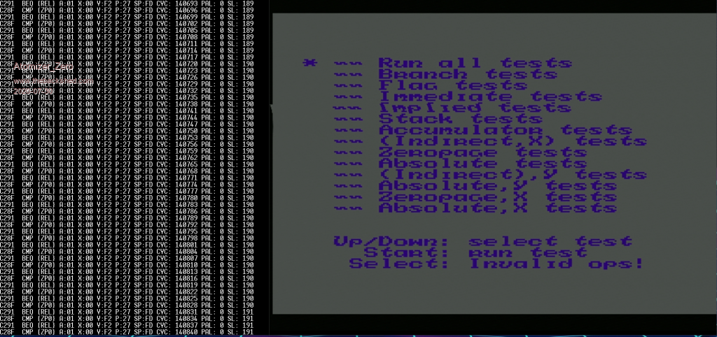

I've been holding off on sharing any details about this current project. I wanted to at least get something displaying on the screen first..
So, some backstory. A youtuber called JavidX9 did an amazing video series on programming a NES Emulator in C++. I followed that some time ago, and essentially ported it to Java. It wasn't an easy task, as many of the conveniences of C++ don't translate at all/well to Java. Either way, it works great in Java (without sound...).
So, 3 or 4 weeks ago, I started porting that code to MMBasic (first with the win/dos version, testing things out), and now on the CMM2.
It's finally "running". It SLOW AS ALL HECK! of course. takes about 10 minutes to actually show anything, and of course, barely anything actually works, but as far as I can tell so far, the cpu is pretty much in fully working order (minus unofficial opcodes..)

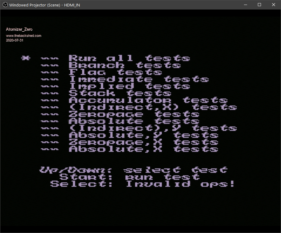

On the left is the serial output, displaying debug info and on the right is the video output captured via OBS. The rom being run is "nestest.nes", which is designed for tesing the cpu, especially when the ppu (the graphics processor) isn't working properly; which is the case right now. The display is actually more of a hack to actually get it to draw... more work needs to be done.
The code is currently very much unoptimized, as you would imagine, so I know it can get faster with time.

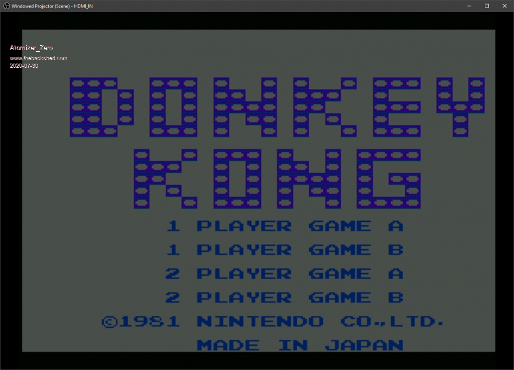

We have hit the Donkey Kong title screen! This is great news, as it's proof of the cpu working as intended. It takes around 15 minutes to get there... but it does get there lol. Still, the PPU isn't working correctly. Sprites aren't loading yet. Lots more work to do.

Currently, I'm fighting with the PPU. For some reason, the palette table isn't returning the colour information when I need it to. If I don't read from the ppu, and just pass the colour table directly, I end up with the screenshots I posted before. Fun to see it works, but obviously, the colours aren't correct.
Atomizer_Zero
Joined: 04/07/2020
Posts: 134
Posted: 03:28pm 30 Jul 2020
DONE IT! PPU working, finally.

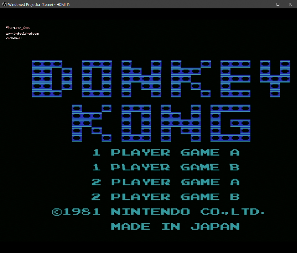

Not all good news unfortunately...
this is better, but the palette selection isn't working. And neither are the sprites... back to the debugging lol

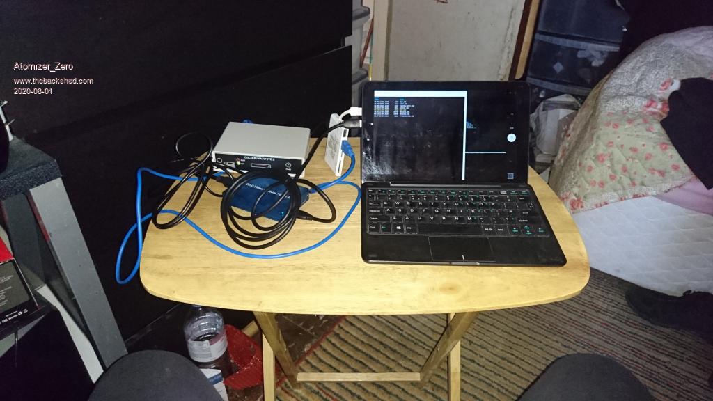

So, since last night, we've been having frequent power cuts. There's a problem with a wire underground apparently.
So, I've had to get a little creative..
Introducing, my portable battery powered cmm2 dev environment lol

Posted: 03:25pm 31 Jul 2020
Way to improvise!
Just need to find a VGA recording device to pull VGA back in through USB and display on laptop for a closed-loop solution.  :)
