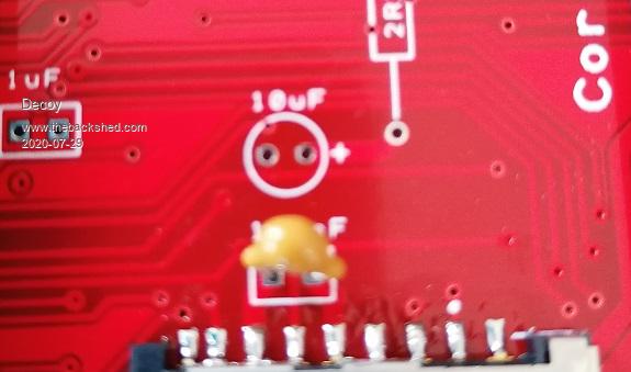

Hi guys
More parts finally made it to my neck of the woods - thus I am moving on with the assembly of the board.
My question is regarding the 10 uF tantalum capacitor. Looking at the PCB, the marking just looks like a standard 10 uF electrolytic capacitor. So, what is the deal with the tantalum? What does it do in comparison with other capacitors and what does it do on the board?
Thanks!

The tantalum capacitor you are showing in the photo (or at least the place where it will go) is part of a filter circuit for the power to the SD card.

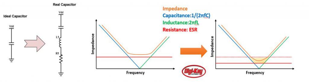

Tantalum capacitors have a lower ESR (Equivalent Series Resistance) than normal electrolytic capacitors.  In simple terms, this allows them to "respond faster" to voltage changes.  A perfect capacitor would have an ESR of zero, in the real world a capacitor acts like a capacitor with a resistor in series and also a small amount of inductance in the leads and structure of the capacitor.  For a 10uf electrolytic capacitor this would be on the order of several ohms.  For the tantalum cap it might be less than one ohm of ESR. The small 100nF ceramic capacitor next to it should have an extremely low ESR (i.e. less that 0.01 ohm)
On the CMM2, this capacitor will supply power to the SD card when the power demand of the SD card "surges".  The filter circuit prevents noise from the other components on the board from reaching the SD card.  It also prevents the power demand of the SD card from feeding back and affecting other components in the system.  This is sometimes referred to as "Decoupling" or "Bypassing"
Do a internet search for "ESR" for a more technical explanation.

Posted: 09:28pm 28 Jul 2020
Thanks for that! That was a very nice explanation.
So, I will wait for them to show up - and not use a electrolytic in its place :)
