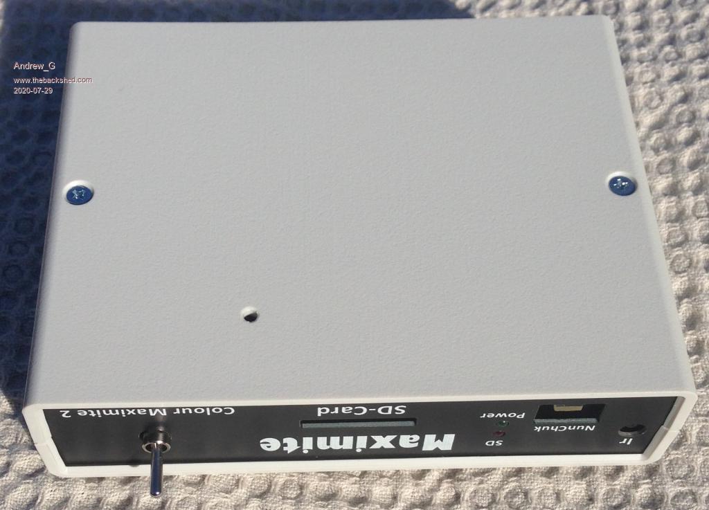

Andrew_G
Joined: 18/10/2016
Posts: 890
Posted: 12:33am 29 Jul 2020
Hi all,
Just yesterday I installed a little slide switch (Jaycar, SS0834 but RS do them too).
A 3mm hole in the base allows me to slide it with a jeweler's screwdriver.
I'll now check out Peter's new approach.
(Edit: I've easily updated the firmware and am starting to play with Peter's changes - incredibly comprehensive. Many thanks to you all - A)
