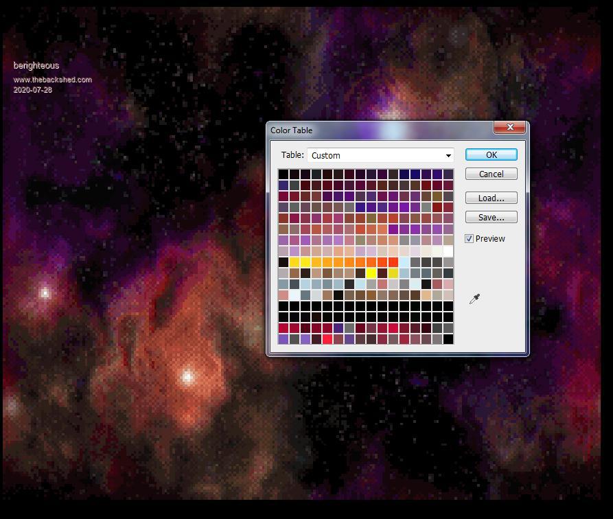

I wrote several 320x200 vga games for the dos PC way back in the late 90's.  All the art is in 8 bit bmp files with a common vga palette which photoshop can save as an ACT file. If I want to recreate the games on the CMM2, can I just bring the pictures in and set the 320x200 CLUT with the ACT file?

The act files are 768 bytes and are 3 hex bytes per color r,g,b for 256 colors starting with color 0
