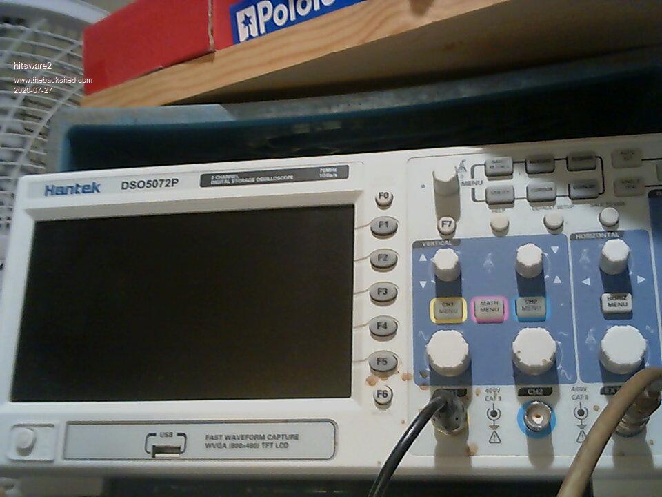

> the 'competition' is something like a Hantek DSO5072P,
Speaking of which :
my site
