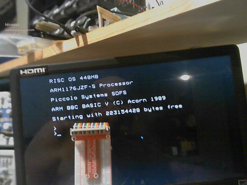

Posted: 02:53pm 27 Jul 2020
  Volhout said
The pi doesnt have analog inputs.
I know .
I am ( at this point ) simply trying to get a trace .
I hadn ' t considered syncronizing with the display .
I get what appears as row of flickering random dots : (
RISC BBCBasic has a WAIT that supposedly addresses the
video problem but slows it to unusability .
Edited 2020-07-28 00:54 by hitsware2

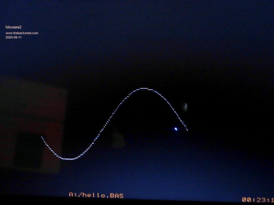

Posted: 11:03pm 10 Aug 2020
setpin 7, ain, 8
do while inkey$ = ""
cls
for x% = 300 to 555
pixel x%, 300*pin 7
next x%
loop
end
' ~ 45 Hz ( I'm sure
' there is a truth there )
