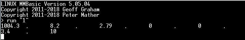

lew247
Joined: 23/12/2015
Posts: 1709
Posted: 06:15pm 25 Nov 2020
Thank you so much
Working perfectly now
Sent data to HC-12
Received data from PC via HC-12
I'm hoping the spaces between the commas on the receiving micromite once it's set up won't cause a problem when it comes to parsing
Edit: I spent over 2 weeks trying to extract that information using Python from a Pi that's got a weather display attached
I did it using Pi-Cromite in a day
It would have been a couple of hours if I hadn't messed the field$ up
