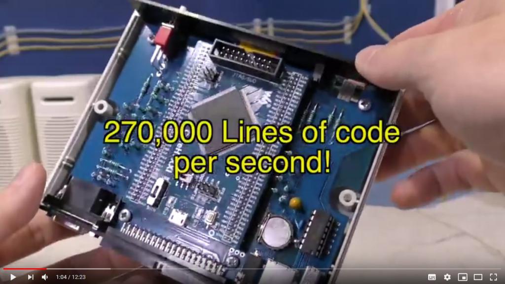

Posted: 02:16pm 16 Jul 2020
https://www.youtube.com/watch?v=IA7REQxohV4
This Guy apparently just took it from here.
  Quote  Full featured BASIC interpreter with double precision floating point, 64-bit integers and string
variables, long variable names, arrays of floats, integers or strings with multiple dimensions, extensive
string handling and user defined subroutines and functions. Typically it will execute a program at
270,000 lines per second.
Colour Maximite 2 User Manual - Page 4
And we need to know how Geoff measured it practically, to have a standard-code for an objective benchmark!

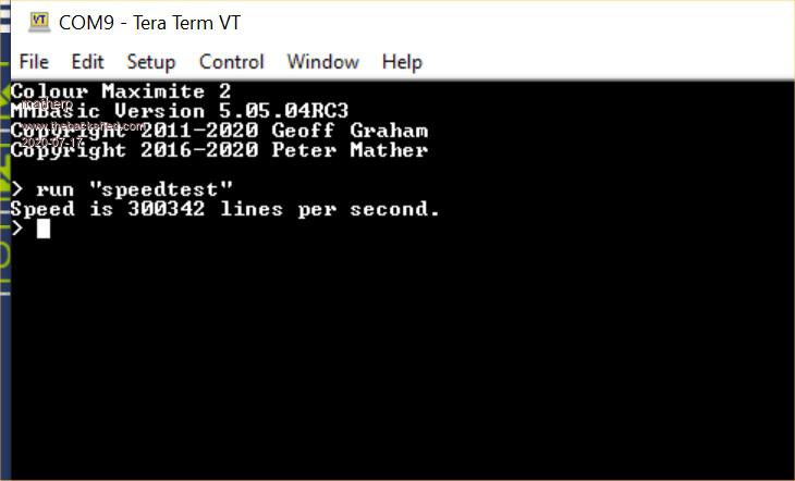

Posts: 12084
Posted: 07:03pm 16 Jul 2020
Coming in RC4

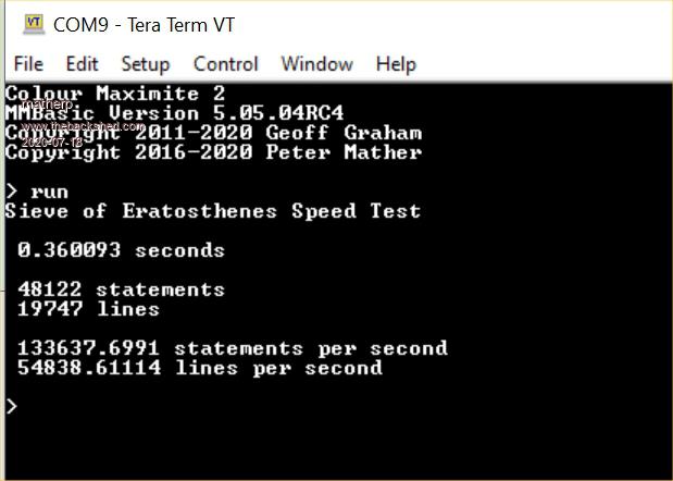

Posted: 01:49am 17 Jul 2020
here is a rather classic speed test:
Print "Sieve of Eratosthenes Speed Test"
Print
Start = Timer
10 W=500:Dim F(W):P=1:A=3
20 F(P)=A:P=P+1:If P>W Then GoTo DONE
30 A=A+2:X=1
40 S=A/F(X):If S=Int(S) Then 30
50 X=X+1:If X<P And F(X)*F(X)<=A Then 40
60 GoTo 20
DONE:
Elapsed = (Timer-Start)/1000
Print Elapsed " seconds"
Print
I = 0 ' statement counter
J = 0 ' line counter
Erase F
110 I=I+4: J=J+1: W=500:Dim F(W):P=1:A=3
120 I=I+3: J=J+1: F(P)=A:P=P+1:If P>W Then GoTo FINI
130 I=I+2: J=J+1: A=A+2:X=1
Print ,P Chr$(13);
140 I=I+2: J=J+1: S=A/F(X):If S=Int(S) Then I=I+1: GoTo 130
150 I=I+2: J=J+1: X=X+1:If X<P And F(X)*F(X)<=A Then I=I+1: GoTo 140
160 I=I+1: J=J+1: GoTo 120
FINI:
Print I " statements"
Print J " lines"
Print
Print I / Elapsed " statements per second"
Print J / Elapsed " lines per second"
Print
> run
5.403 seconds
48122 statements
19747 lines
8906.53 statements per second
3654.82 lines per second

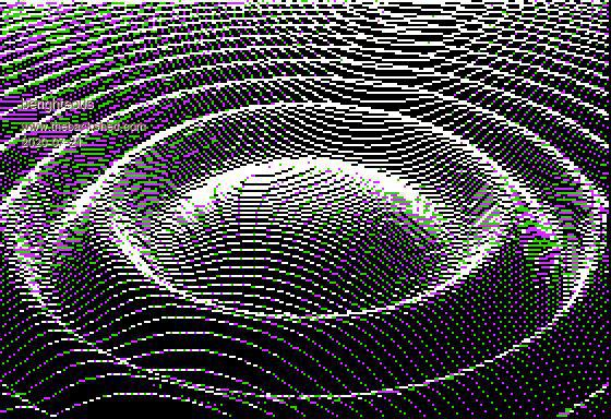

Posted: 12:58am 21 Jul 2020
Does the CMM2 processor have hardware math?  The horrible soul crushing experience with AppleSoft basic is that 6502 had no math above addition and subtraction, so doing something like this plot
takes several HOURS to draw.
Here's the applesoft code for this:
10 GOTO 40
20 XE = - X * S1 + Y * C1 : YE = -X * C1 * C2 - Y* S1 * C2 + Z * S2 : ZE = - X * S2 * C1 - Y *S2 * S1 + Z * C2 + RHO
30 SX = D * XE / Z E + CX : SY = CY - D * YE / Z E :RETURN
40 RHO = 30 : D = 350 : THETA = .1 : PHI = 1 : CX =140 : CY = 96 : S1 = SIN (THETA) : S2 = SIN(PHI) : C1 = COS (THETA) : C2 = COS (PHI)
50 DEF FN Z(X) = COS (.1 * (X * X + Y * Y))
60 HGR2 : HCOLOR= 3
70 FOR X = -20 TO 20 STEP .3
80 FL = 0
90 FOR Y = - 20 TO 20 STEP .07
100 Z = FN Z(X): GOSUB 20
110 IF SX < 0 OR SX > 279 OR SY < 0 OR SY > 191 THEN FL = 0 : GOTO 140
120 IF FL = 0 THEN FL = 1 : HPLOT SX,SY
130 HCOLOR=3:HPLOT SX,SY:HCOLOR=0:HPLOT SX,SY+1 TO SX,191
140 NEXT Y,X
150 PRINT CHR$(7):GET Q$:TEXT
Even in AppleWin on full speed (like 100x apple native) it took a few minutes to do.
