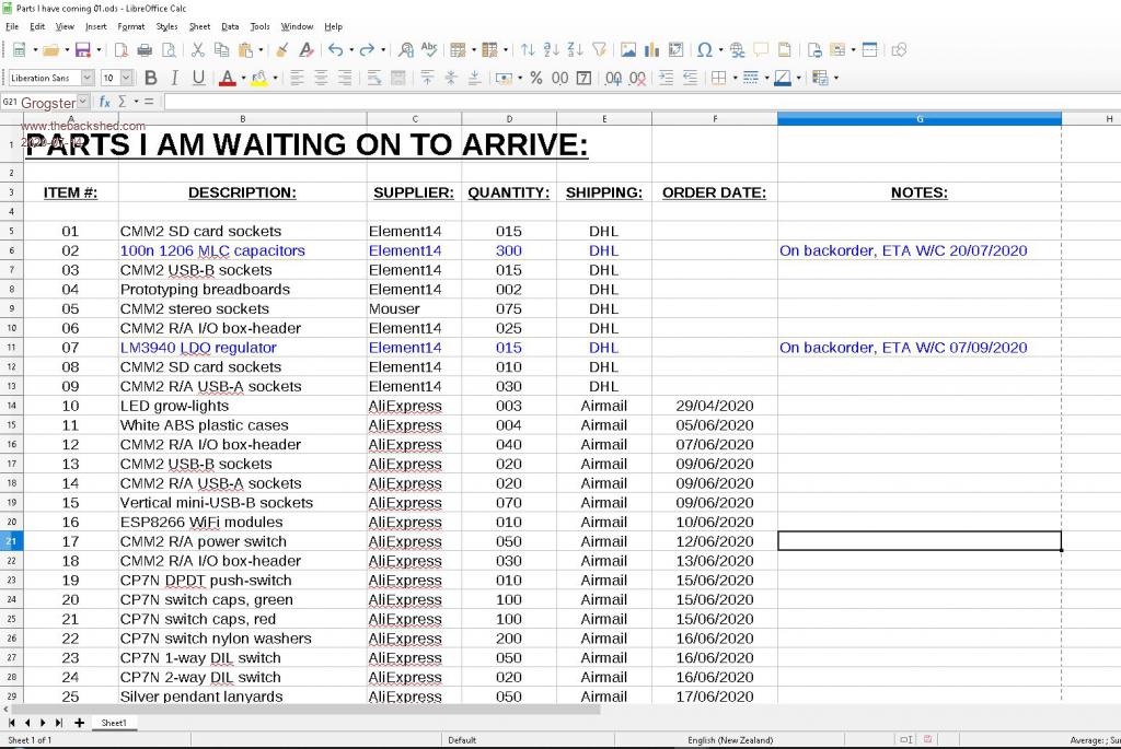

I have made a simple spreadsheet to keep track of all the bits I am waiting on to arrive, due to the massive delay in getting stuff cos of the virus. (with the exception of DHL or FedEx, naturally.)
Here is a screenshot:
This is fine, and it works, but I can only make the simplest of simple spreadsheets(cos I have not learnt how to do anything but simple stuff), so what I really want to be able to do, is delete rows as things arrive, and have column A auto-update the item number - otherwise if I receive item #17 for example, I then have to manually re-number all the numbers on the rows below.
I have about 50 things I am waiting for, for various jobs at the moment, so the spreadsheet should help me keep track of that, without having to re-logon to all my suppliers to remind myself where I was getting part X from, and how many I ordered.
I expect there are a few spreadsheet gurus here on the forums, so could one of you please tell me how I make the sequential numbers in column-A auto-update, if I delete any one row?

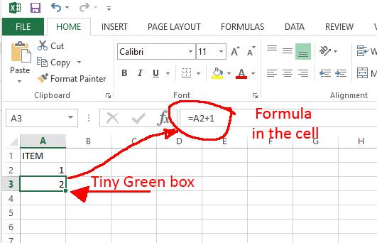

The VERY FAR left where the ROWS are numbered RIGHT CLICK on the number you want to delete and Excel brings up the menu and select DELETE The area to click is GREEN in this picture.
As to auto increment the Item#, just set the first cell as 1 then the one underneath (assuming cell is A2) is =A2+1 then the one under that as =A3+1 etc etc..
When a ROW is deleted the formula will auto update if you happen to delete the first row then just change the cell to 1 and the formulas keep going down
A simple way to copy the formula is to do the first formula in the second ROW (first row having the number 1 and see the tiny green box on the bottom right of Cell A3 in this picture click and hold whilst dragging down and the formula will auto complete till you let go

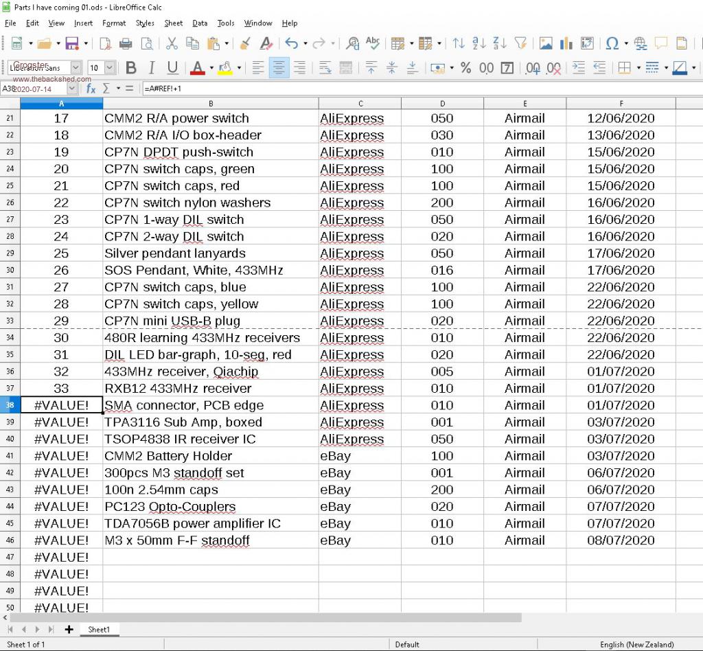

@ Mick: Does not want to co-operate.
....then if I delete row 38(item 34):
So, no luck there - the auto-update totally loses its reference to the first cell.
Thanks anyway.

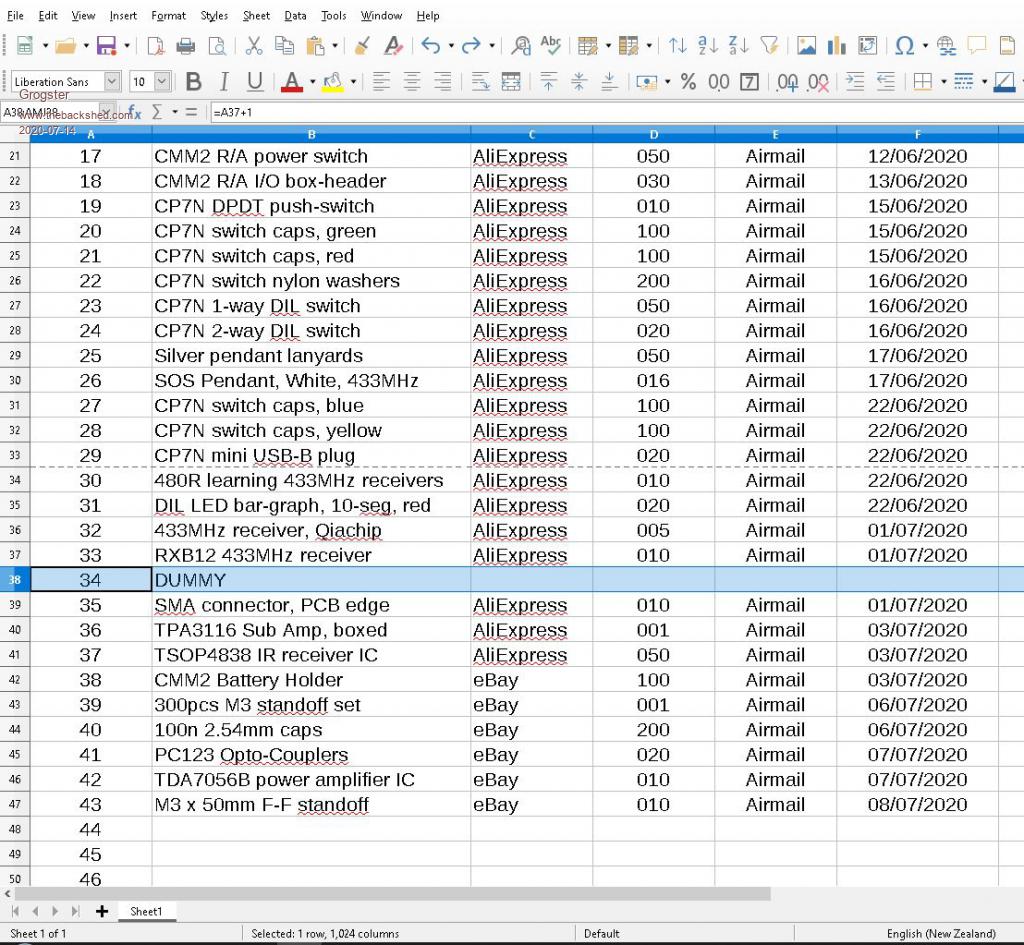

Posted: 09:38am 14 Jul 2020
You should be able to use the ROW function to query the cell coordinates -  if you don't specify a reference it will use the cell containing the formula.
In your case it would be something like "=ROW()-4".

Posted: 09:47am 14 Jul 2020
Grogs,
Try formula
=ROW()-4
-4 in this example is just an offset to align number '1' with row 5 as per your spreadsheet screen-shot above.
Drag formula all the way down. I think this does what your after?

Posted: 11:54pm 14 Jul 2020
@ MikoKisai: Danke!  Yes, that works beautifully!  I can delete the dummy line, and the item column is updated correctly.  Thanks a bunch.
@ vk2sja: Same as above comment.  MikoKisai posted the forumula before your post, so he gets the credit for that, BUT you said to just drag down to copy the forumula to all the other cells, and that did work.
Great.  It's doing what I wanted it to do now, so I consider this problem solved.
