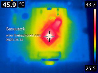

Here is a thermal image of the CMM2 V2.1 PCB:
You can clearly see the CPU is the hottest part on the top of the PCB.  You can also see the heat from the Voltage Regulator (mounted on the bottom of the Waveshare module) just above and to the right of the CPU.  Also notice the SD card at the bottom edge of the PCB and the PIC16F1455 on the upper left are giving off some heat (~32C)  I would suspect that the Voltage Regulator is likely the hottest component but I cant get a clear view of the bottom of the Waveshare module.

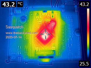

Here is a composite image (visible + thermal):
Note that there is a small offset in the two images due to the parallax between the two cameras.
Unfortunately, the small 32.768kHz watch crystal for the RTC is mounted on the bottom of the Waveshare module between the CPU and the Voltage Regulator.  I think I am going to try to move the crystal to the top of the board standing vertically on it's leads to isolate it as much as possible from the heat soruces.

The CMM2 was "idle" not running any programs.  With all the background stuff MMBASIC does (timers, video etc.), I'm not sure it would make much difference, but it's worth a try!
The CMM2 was out of it's case for the pictures and the internal CPU temp (Pin("Temp")) running at about 42C after letting everything stabilize for about 1/2 hour.  It seems logical that it would run a bit hotter inside a case.

Ok, I ran the pure MMBasic version of Mandelbrot in a loop for about 1/2 hour and not much difference.  Maybe 1C higher but this is within the margin of error for room temp changes etc.
I think that the CPU is likely running full speed even if it's not doing much other than the MMBasic background timers and interrupts.  Running some heavy math may exercise other parts of the chip however.

The thermal images are great to have(IE: they look great!), but yeah, she runs 100% CPU clock at all times.  Essentially, you are saying that the CMM2 is hot.
Seriously though, it is fine with anything up to about 75'C.
Allowing for thermal-lag between the actual die on the ARM processor, and the external heat figure as measured, there is no problem looking at the stats from the thermal probe images.  Generally speaking, the CMM2 "CPU" ARM chip only gets "Warm to the touch."  There is no need for any kind of stick-on heatsink(although that will not hurt if you want to), so anyone who tries to sell you a 'CMM2 heatsink kit' sort of thing, is simply ripping you off.  Same thing happened with the original CMM from what I remember reading years ago.....
