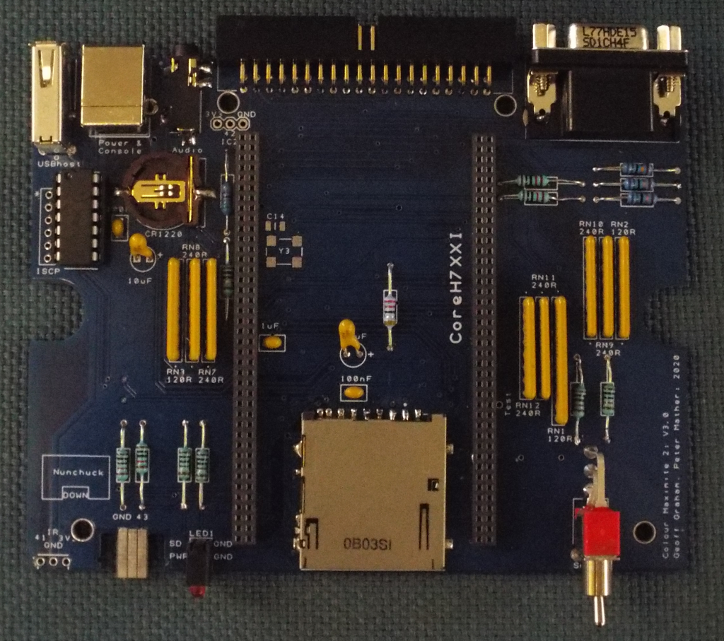

Greetings Everyone ...
I am a new forum member, and have just completed my Maximite2 kit
For the benefit of anyone who is also building one of these, here are some notes I made on the process ...
Maximite 2 Kit v3.0 PCB from www.micromite.org (Phil Boyce in the UK)
https://micromite.org/shop/maximites/colour-maximite/colour-maximite-2-kit/

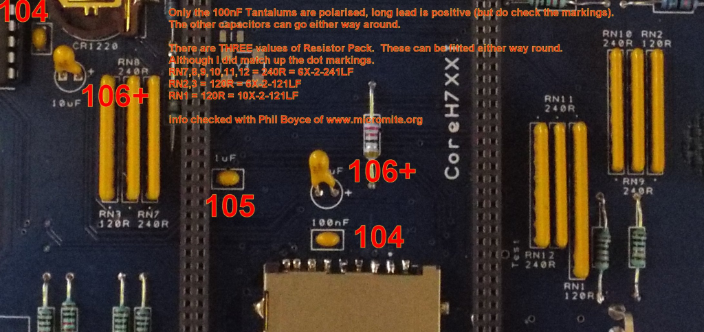

This is the v3.0 PCB with the resistors replaced by Resistor Packs
Only the 100nF Tantalums are polarised, long lead is positive (but do check the markings).
The other capacitors can go either way around.
Capacitor Markings:
10uF = 106+ (polarised Tantalum)
100nF = 104 (can go either way round)
1uF = 105 (can go either way round)

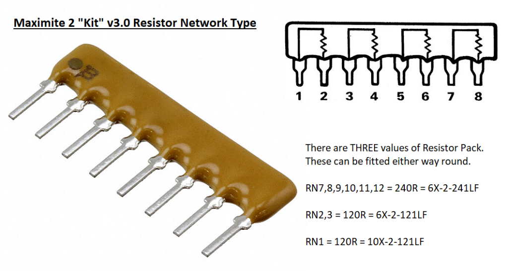

There are THREE values of Resistor Pack.  These can be fitted either way round.
Although I did match up the dot markings.
RN7,8,9,10,11,12 = 240R = 6X-2-241LF
RN2,3 = 120R = 6X-2-121LF
RN1 = 120R = 10X-2-121LF

The machine lives
Board fired up yesterday, and case completed today.
I have been hacking around with some of the demo code trying to get a feel for this dialect of Basic.
Still a few teething problems.  I'm getting some noise on the video output, which may be down to my monitor, and some interference in the audio playback which seems to be picking up distortion from the video output.  However so far I am very pleased with the build.
Many thanks to the Dev Team for an excellent little computer.

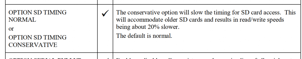

Regarding SD Card wierdness ...
On my machine I  was having problems with the SD Cards not being detected.  Sometimes they worked, sometimes nothing showed up
F1 to open file browser ... may show nothing and an error message is displayed
I am running version CMM2V5.05.03.bin firmware from the CMM2_Construction_Pack.zip
I appreciate that there are newer firmwares out there
I found that setting
OPTION SD TIMING CONSERVATIVE
fixes this on older firmware versions (eg. CMM2V5.05.03.bin)
I am told this is due to be changed on future releases, and will default to this (but called NORMAL)

You mention polarised capacitors:
  Quote  Only the 100nF Tantalums are polarised, long lead is positive (but do check the markings).
That should read only 10uF are polarised.
Also,
If you install the latest firmware, it defaults the what was "OPTION SD TIMING CONSERVATIVE" with the alternative option of "FAST" available.
There are other bug fixes so I would recommend using the latest firmware, especially at this early stage of the journey.
My bad  , I wrote these notes the day after I built the thing
10uF Tantalums are provided in the kit

Definately get onto the latest BETA firmware.
I was also bitten by the SD issue until someone pointed out CONSERVATIVE option.
Much better now that the default is the marghinally slower (but seemingly more compatible) speed, and those wanting to experiment with faster speed can try FAST.

I'm going to install one of the beta firmwares tomorrow, now I have a working MCP2221A
A very nice chap clued me in on the SD issue ... shout out to Phil Boyce (aka WhiteWizzard ... Hope I got that right) I cannot recommend the service received from micromite.org highly enough ... Exemplarary

I note that the MB you have has been redesigned to accommodate resistor arrays, therefore the layout of the digital lines is different from the standard WS MB that I'm using, not saying there is anything wrong, it may be better, just a difference.
I know that layout definitely contributes to noise in 800x600 modes. I proved that when I had my WS module wired up with short leads tacked onto the top of the PCB connectors (top of the WS board) as no sockets or MB were available at the time. In that test setup there was a small amount of Horz jitter on mode 1,12. Those leads were short and right away from the CPU, I did a lot of testing and never eliminated it.
When I finally built the Motherboard and with the same WS board, the video was worse with noticeable jitter / tearing now on mode 1,8 and really bad on Mode 1,12 /16. So it followed the R-2R layout. BTW all of the 640 modes are fine.
Mike.
