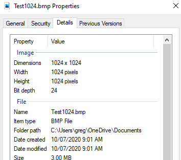

Edit:  For reference, here is my 1024px image properties:
