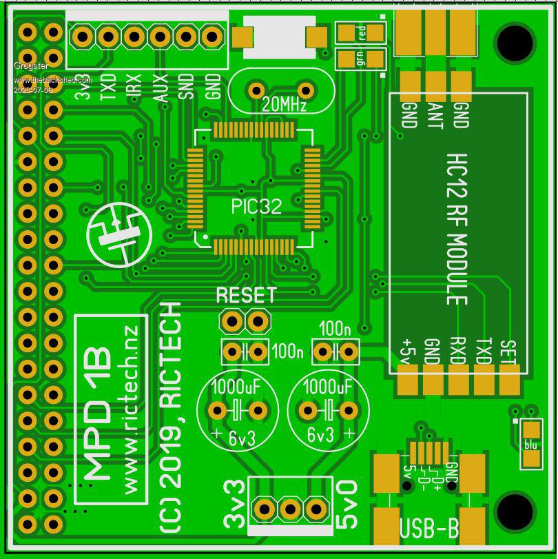

EDIT: Here is an image of my controller board:
Note that I have 1000uF 6v3 caps on the 3v3 and 5v supplies, which should surely be able to deal with any start-up current when the board tries to initialise the LCD....

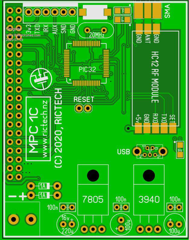

Anyhoo, I have redesigned the board, making it 15mm longer, and incorporating good 'ole linear regulator stages:
The large 'Green' area around these regs, is copper GP/pour, to act as a form of heatsink.  I plan to feed this from a single 9v supply capable of a few amps at least.
This will mean that the 7805 will dissipate about 1.19W of heat, which should be fine using the copper as the heatsink.
9v - 0.6v(diodes) - 5v = 3.4v, * 0.35A total load = 1.19W of heat.
If I used 12v input, dissipation of 7805 would increase to 2.24W, or 2.87W @ 13.8v input from a battery-backed PSU unit, which is PROBABLY what I will use.  This is still well within the dissipation of the 7805, albeit getting a bit on the hot side.
5W is about as far as I would be prepared to push it.  I can also add stick-on heatsinks for extra dissipation, but I guess I will need to run a few tests with this arrangement and see how hot she gets!

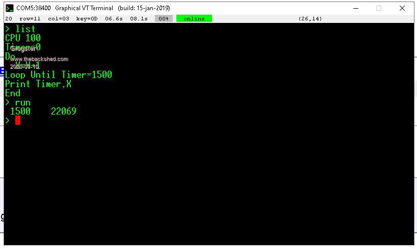

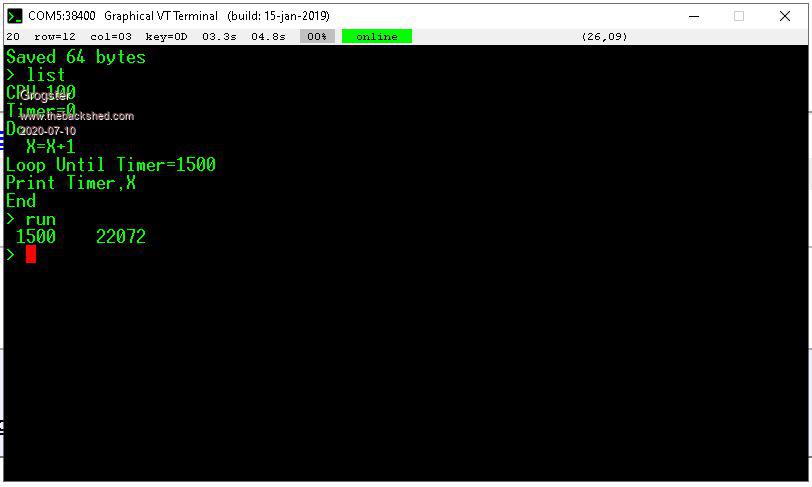

My first thought is power supplies, but another though I had was to set up a simple timing loop speed test both boards and make sure that both boards are running at the same speed.

#1 test:
#2 test:
There is only 3 counts between them (22072 vs 22069), so they seem to be smack-on timing wise.  I guess I would need to do multiple tests and compare the results for true accuracy.

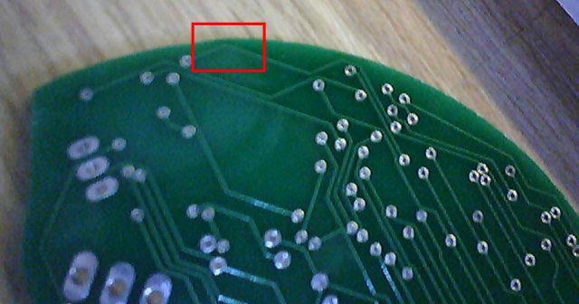

  OA47 said  Just my 2 cents worth, have you checked the vias on the faulty board?
OA47
Not SPECIFICALLY, but I did do the LED testing, and that certainly shows that all the connections are present and accounted for.  The LED testing won't show high-resistance vias though, so I will do some probing around just to see if there is anything odd going on there.
You never know, but out of all the PCB's I have had made(hundreds and hundreds now), I have only EVER had ONE board that had ONE via that was bad.  Not saying bad vias could not be the issue, but I think it would be extremely unlikely.  Still, I will do some probing as I said.

Finally tracked it down to the LCD CS pin NOT being grounded.  It WAS connected to the surrounding ground-plane, and it did show as connected to ground when I tested the connection in the layout software, but it was on the outer edge of the PCB, and when they slice them up in the factory, that cut off the connection to the ground-plane.
