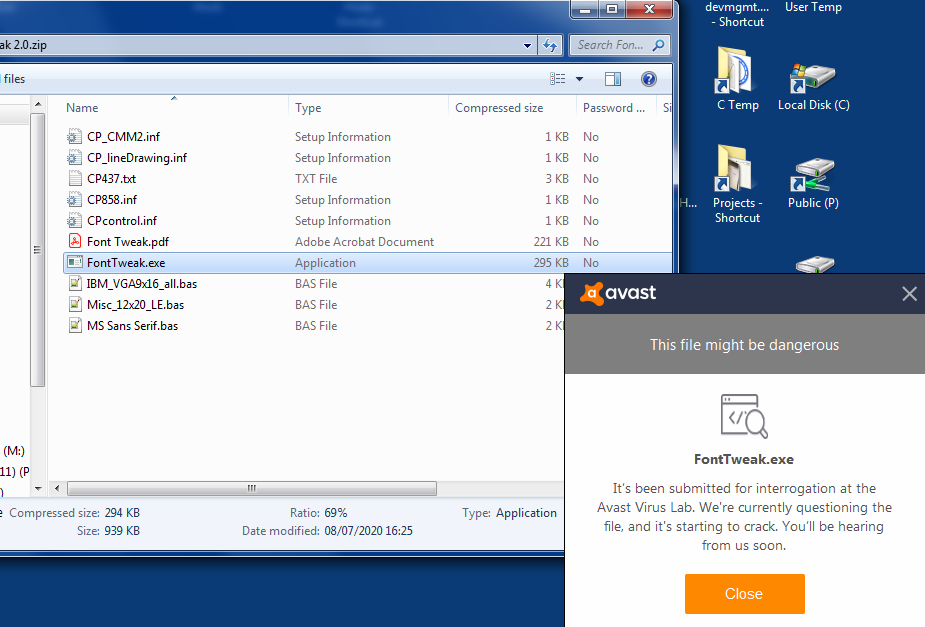

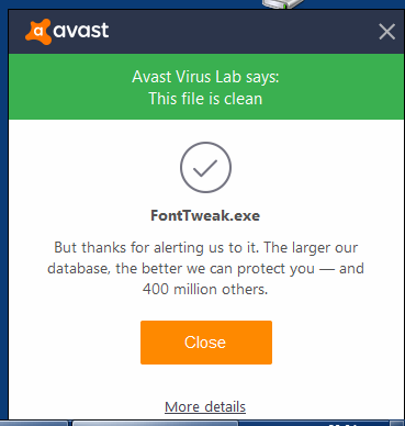

YAY! New version of FontTweak!
boo! another AV that gets the tom-tits about FontTweak. This happens a lot for this prog I hear. Weird coz it's a fairly straightforward application - perhaps a library call or something gets their diddy-donuts twitching. When (If) they come back, I shall harangue them for you and find out precisely what qualified it as dodgy then feedback (as an aside, I do not think for one moment it is dodgy).
Edited 2020-07-08 19:47 by CaptainBoing
Posted: 10:05am 08 Jul 2020
Sorry about the virus warning but there's not much I can do about it.
One problem I have since discovered.
If you try and use a font directly from the file instead of installing it, it will only work if the file name is exactly the same as the font name.
I will have to work out how to reliably extract the font name from the TTF file.
I knew something was going to bite me when I started chasing TTF font files.
Posted: 10:09am 08 Jul 2020
no apology necessary Jim, I know it's not you.
I tried running it directly from the Zip (i.e. using the previous install's libs etc) and copied to another place on my PC but same.
I was chatting to a colleague about why this particular program and he pointed out that avast may not be very forth-coming on *why* for two reasons:
1. it is a lot easier (read cheaper) to simply "rubber-stamp" the prog as OK
2. they might not want to reveal a potential work-around for nefarious little scroats that have an interest in getting genuinely crappy software under the radar.
Another AV prog for the list
watch this space
Update 20:04
what we already knew:
Edited 2020-07-09 05:07 by CaptainBoing
