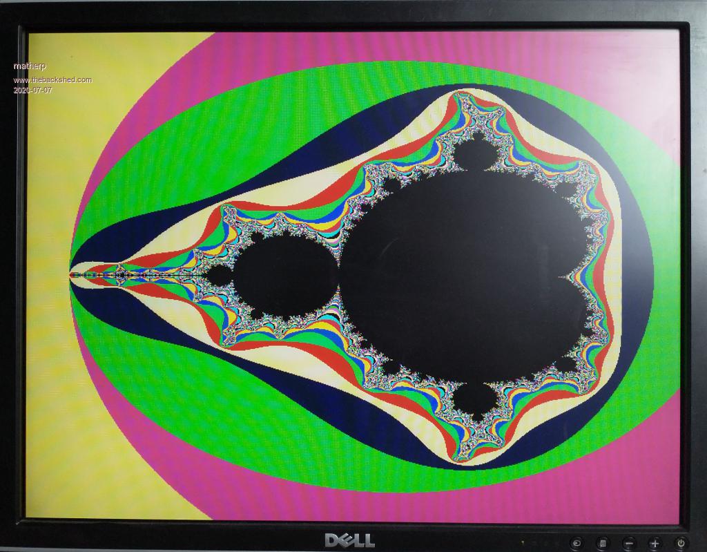

Takes 1.6 seconds to run 800x600
Video
mandelbrot 64 'parameter is the maximum number of iterations
do:loop

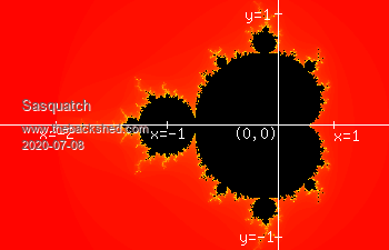

The coordinate system looks like this:

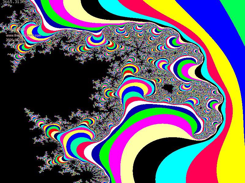

Here is an example screen dump.  As you can see in the uper left hand corner, it took 3.6seconds to render at 800X600.
Depth = 64
Scale = 50.0
XCenter = 0.3935871840
YCenter = -0.1475255520
Edited 2020-07-08 08:59 by Sasquatch

Here is a pure MMBASIC implementation.
Its slooooowwwwwww
CLS black
CONST w = MM.HRES
CONST h = MM.VRES
CONST maxi = 100
CONST colors = 65536
DIM sx AS FLOAT
DIM x AS FLOAT
DIM y AS FLOAT
TIMER = 0
FOR py = 0 TO h - 1
 REM Scale Y axis
 sy = (py / h) * 2 - 1
 FOR px = 0 TO w - 1
   REM Scale  axis
   sx = (px / w) * 3.5 - 2.5
   vy = 0
   vx = 0
   i = 0
   x = 0
   y = 0
   do WHILE (x^2 + y^2 < 4) AND (i < maxi)
     xt = x^2 - y^2 + sx
     y = 2 * x * y + sy
     x = xt
     i = i + 1
   loop
   c = i/maxi * colors
   pixel px, py, c
 NEXT px
NEXT py
PRINT TIMER "ms"
SAVE IMAGE "mandel.bmp"

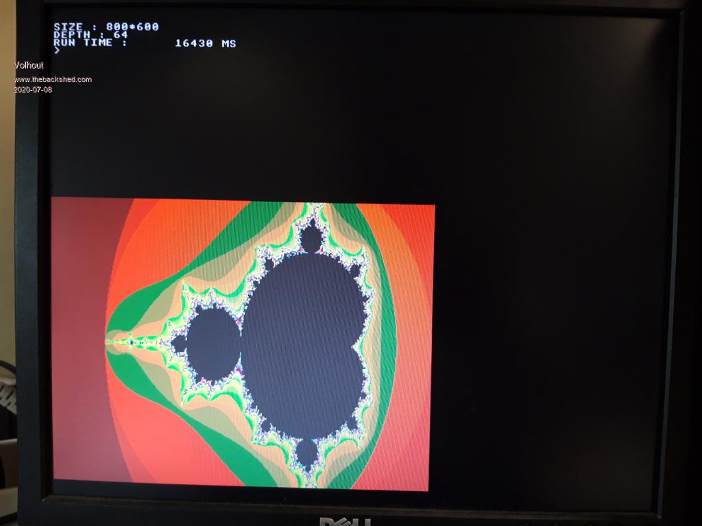

Ported to BBC V basic running on the raspberry Pi zero.
MODE 28
w = 800
h = 600
maxi = 64
TIME = 0
FOR py = 0 TO (h/2 - 1)
 FOR px = 0 TO w - 1
   i = 0
   x = 0
   y = 0
   WHILE ((x^2 + y^2 < 4) AND (i < maxi))
     xt = x^2 - y^2 + sx
     y = 2 * x * y + sy
     x = xt
     i = i + 1
   ENDWHILE
   GCOL i/maxi * 64
   POINT px, py
   POINT px, h-py
 NEXT px
NEXT py
PRINT TIME*10
run time : 16 seconds (10x slower than the CMM2 CSUB)
