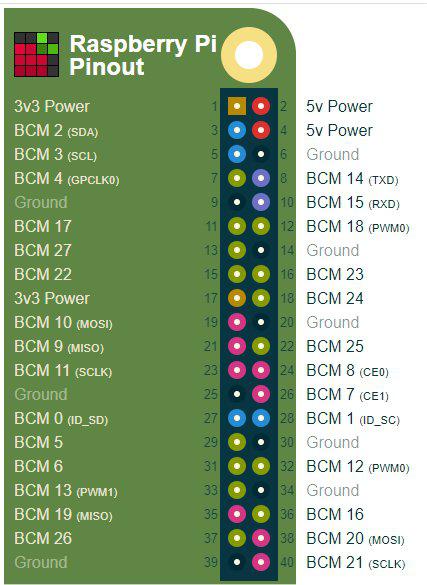

One concern about using pins 27 and 28, since I think they're also the recommended pins for one of the I2C ports. Would there be a risk of hardware damage if someone had the joystick buttons connected there as listed above, but the program was expecting the Nintendo nunchuck? That would be bad.
I don't think there would be any problem the other way around (i.e. nunchuks plugged in when joystick buttons are expected), since if the program was expecting joystick buttons it would just be reading the pins.
