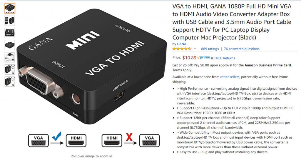

3. GANA VGA to HDMI connector
This one is really good. 800x600 mode is very crisp and no annoying timing shifts. Likewise 320x200 is very sharp. My only complaint about this adapter would be that 640x400 is noticeably more blurry than the other two modes I mentioned. I’m not sure if it’s the adapter or the implementation of Maximite but since the modes I mostly care about are sharp I’m sticking with this adapter.

Let me clarify that in 640x400 mode both the QGeeM and the GANA are about the same level of blurry so there is no reason for me to hang on to the QGeeM so it’s going back to Amazon as is the AmazonBasics one.

I bought this. Sharp images in all modes.
