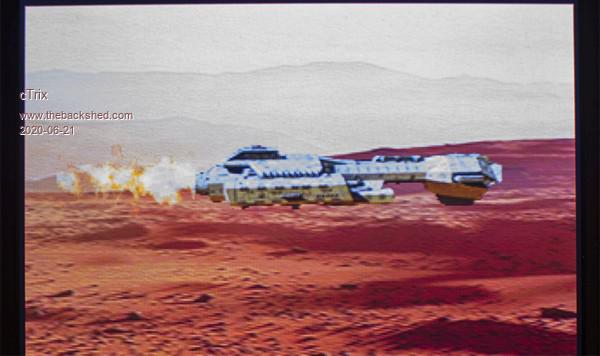

With the 12-bit mode : I'm having trouble getting sprites to work with the 4-bit alpha channel (importing from PNG).  I haven't yet figured out how to do this... it always just masks the shape like it would in 8-bit or 16-bit mode.
I know there is some kind of interleaving page modes for RGB vs. Alpha... so perhaps I need to import a separate alpha channel image to do this?
Say, if I wanted fluffy semi transparent cloud sprites (with varying alpha).
Does the PNG import function even support this?  (I know the PNG format does)
Loving this new Maximite, still figuring the quirks!  (more specifically, how 12 bit ticks)

In the 12-bit modes : I'm having trouble getting sprites to work with the 4-bit alpha channel (importing from PNG).  I haven't yet figured out how to do this... it always just masks the shape like it would in 8-bit or 16-bit mode.
Meanwhile : I love page stitching!  But is there a way to vertical page stitching?  Or do I have to do it the manual BLIT way between screens?  My first test code was a vertically scrolling background and I got stumped straight away because an offset more than 320 (in VGA) seemed to crash it.
Edited 2020-06-19 23:26 by cTrix

At the moment the firmware imports png pixels as either transparency 0 (transparent) or transparency 15 (solid) based on the value of the cutoff parameter in the import, assuming an ARGB8888 png file (see the manual and this thread for details.
I was going to import with pixel specific transparency but couldn't find an algorithm that worked when mapping the 256 transparency levels in ARGB8888 to ARGB4444. Imported images just ended up a mess. So it is one or the other at the moment. You can then change the transparency of the complete sprite using the SPRITE TRANSPARENCY command. There isn't currently a way of doing pixel specific transparency in sprites.
I'm open to re-visiting this at a later date but for the moment at least it works in a way that is understandable.
PAGE STITCH only works for horizontal because this requires much more processing than vertical where there would be no useful performance gain over two BLITs

Update on Vertical Stitch:  I've worked on a subroutine where you load the graphics into empty video pages, and it just BLITS between them with two BLIT commands.
12-bit : Meanwhile, for things like car windows or glass panels, I'm looking at layered sprites.  Are the vectors (like box command) able to have semi-transparency too?
16 bit mode works great!  I can't believe how big you can make the sprites and still have things scroll well.  Would be amazing if there was a bit more movement on the off-screen sprites before an error came up.  If you have sprites with slightly varying widths it'd be nice to not have to cater for each one being out of range at different values.
