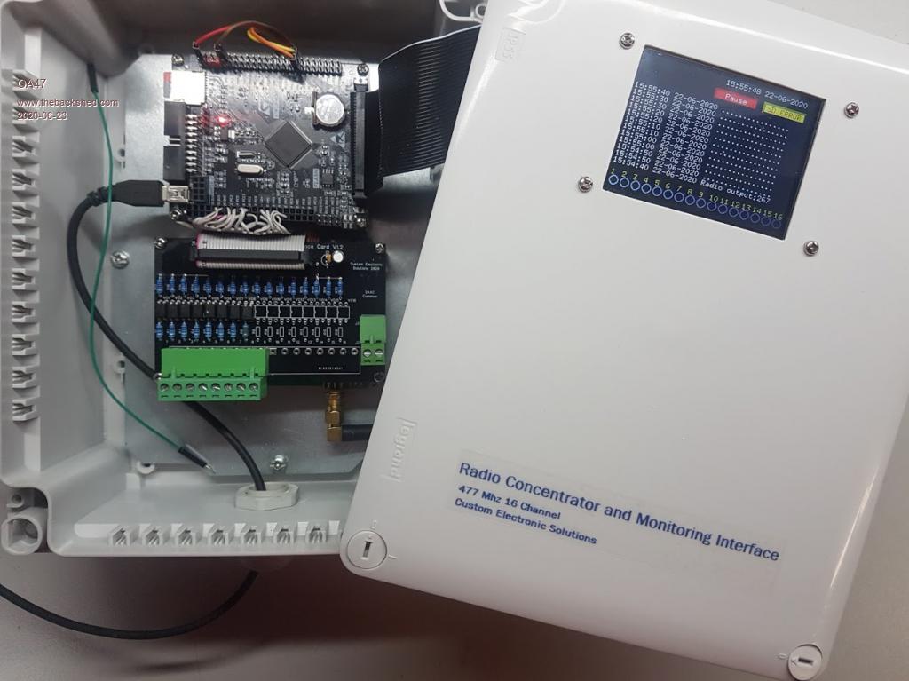

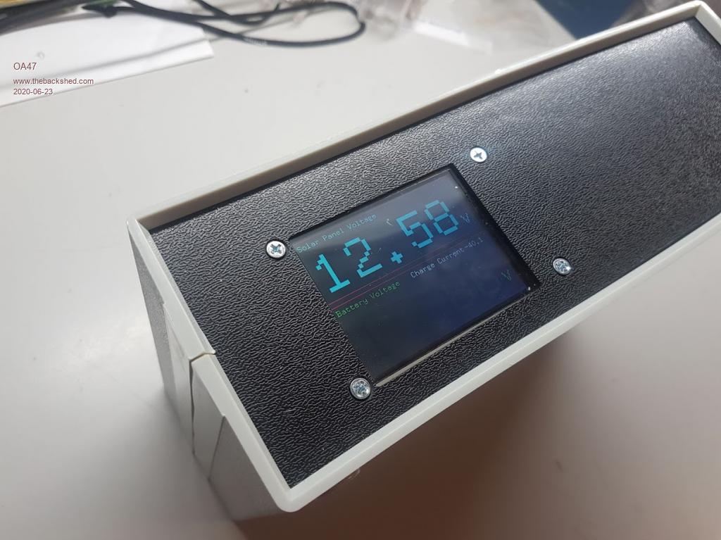

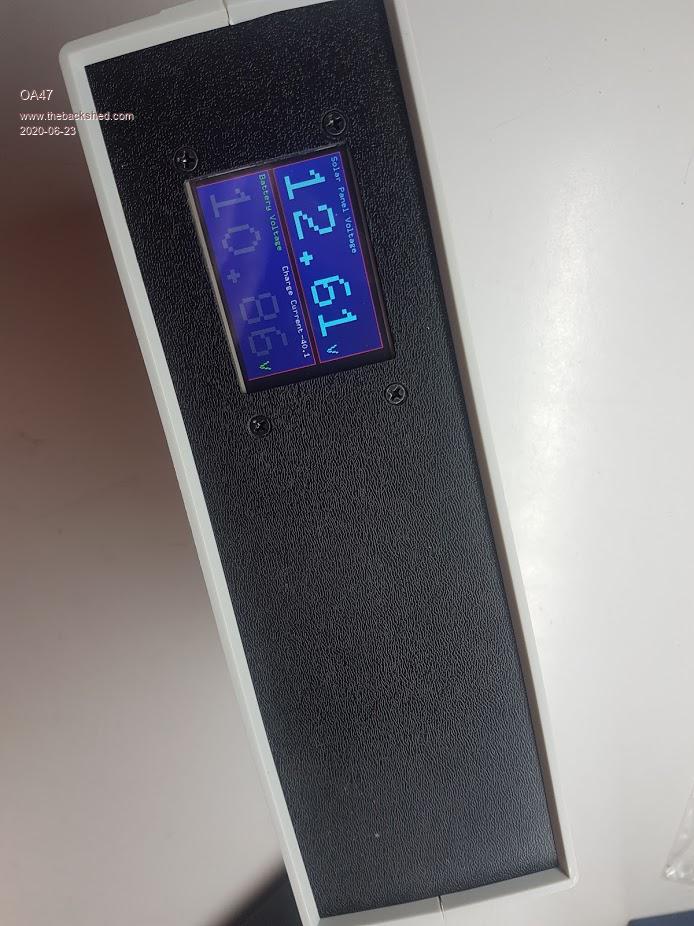

Posted: 10:42pm 22 Jun 2020
  Quote  how about a photo to inspire us cnc newbies ?
3.2" ILI9341
Earlier tests with 2.4 and 2.8 inch in front panels
OA47
