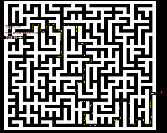

Posted: 03:05am 09 Jun 2020
Excellent work.
My first instinct was black is the walls.
It didn't take long to realise that the walls are white.
It needs a start and end added.
I will add my joystick/mouse reader to it to make a good dexterity trainer, something that I had been planning to do.

Posted: 02:06am 10 Jun 2020
I made a small change to prevent py = 0

This is my mouse track in action:
