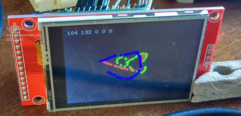

The CMM2 has a nunchuk interface built in. It is ideal for fast game action but I have difficulty using them.
I find the mouse a much easier device to use.
I had a few PS2 mice in the collection so here is a PS2 to serial adapter.
The Arduino nano is cheap and ideal for the job.
It could also be achieved with a micromite but the Arduino was a cheaper choice and I have yet to tackle CFUNCTIONs
I tried to make it suitable for all of the maximite/micromite family but have only tested it on a CMM2 and micromite 170 with 320x240 display.
In the Arduino,
As usual, someone has already done the hard work.
3 buttons work but not scroll.
The PS2 routine takes about 13mS to read the mouse.
It takes 2mS to send the 3 bytes of data at 19200 baud.
19200 is the fastest that all mites can handle.
On the Arduino, pin 5 goes to PS2 data and pin 6 to PS2 clock.
The serial is at 5V so I used a resistor divider to bring the level down to ~3.3V
We could update as fast as 16mS to equal the nunchuk but that would cause unnecessary load on the maximite and is of little benefit.
I chose a delay of 100mS which is added to the 13mS giving a refresh rate of 114-115mS.
In the CMM2, I set the serial to interrupt with 3 bytes in the stream meaning the receiving is all done in the background. There is a chance of the stream getting interrupted so your program will need some way of recovering.
I used j$ = INPUT$(255,#2)
The interrupt Sub updates some global variables and sets flags to indicate mouse movement or button change.
The mousetrap sub takes about 0.15mS on the CMM2 and could be reduced a bit by shifting same of the code into the main loop. 0.15mS every 114mS is not much load.
In the demo, the mouse buttons change the colour of the dots.
L, R and L+R

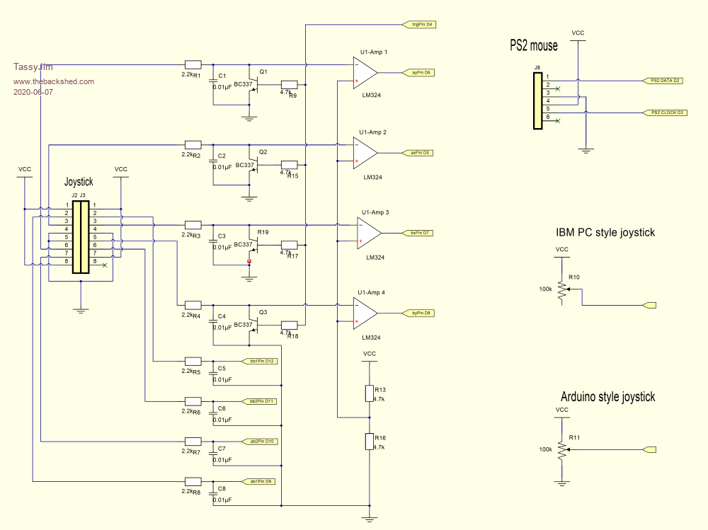

I have added joysticks to the mix.
The common Arduino joystick module has it's pots connected between Vcc and Ground so a simple analog read is all that's needed to get the relative position. They usually have one button which switches to ground.
The real joysticks from 20 years ago are different.
In the real joysticks, there is a ~100k pot connected to 5V but not connected to ground so we get a variable resistance we need to read.
In the original systems, there weren't many ADC converters so they measured to time taken to charge a capacitor. This is directly proportional to the resistance.
This is the method I used.
With minimum resistance, it takes 40uS to charge the 0.01uF capacitor to V/2 and at the maximum resistance about 1200uS
My cheap joystick has higher value resistances so it takes up to 1600uS to charge.
There are 2.2k resistors on all inputs to limit charging current.
The button inputs have 0.01uF filter capacitors.
I used a LM324 for the comparitors but any one that runs of 5V single supply will do.
To start the timing, the capacitors are discharged for 100uS (this could be shortened a bit).
The transistors are not critical and mosfets could be used.
We then record when the outputs of the comparitors return low.
I divide the result by 4 because the nano has a 4uS resolution. The upper 2 bits of the reading are stored in the button byte to give up to 10 bits resolution.
We need the spare room to cater for different joysticks.

 timeZero = micros();
 timeWait = timeZero + 2050; // set timeout
 while (micros() < timeWait) {
   if (axt == 0 && digitalRead(axPin) == LOW) {
     axt = micros()-timeZero;
   if (ayt == 0 && digitalRead(ayPin) == LOW){
     ayt = micros()-timeZero;
   if (bxt == 0 && digitalRead(bxPin) == LOW){
     bxt = micros()-timeZero;
   if (byt == 0 && digitalRead(byPin) == LOW){
     byt = micros()-timeZero;
 /* nano only has 4 uS resolution so divide by 4
    add high byte bits to button byte
   2 bits to identify mouse or joystick, 2 bits for x axis,
   2 bits for y axis 2 bits for buttons
 axt = axt / 4;
 ayt = ayt / 4;
 bxt = bxt / 4;
 byt = byt / 4;
 ab = (highByte(axt) & 3 )*16 + (highByte(ayt) & 3 )*4 + 64;
 ab = ab + (1-digitalRead(ab2Pin)) *2;
 ab = ab + 1-digitalRead(ab1Pin);
 bb = (highByte(bxt) & 3 )*16 + (highByte(byt) & 3 )*4 + 128;
 bb = bb + (1-digitalRead(bb2Pin)) *2;
 bb = bb + 1-digitalRead(bb1Pin);
 if (ab != abo || axt != axto || ayt != ayto) {
   Serial.write(ab);
   Serial.write(lowByte(axt));
   Serial.write(lowByte(ayt));
   abo = ab;
   axto = axt;
   ayto = ayt;
 delay(3);    // give the micromite time to digest
 if (bb != bbo || bxt != bxto || byt != byto) {
   Serial.write(bb);
   Serial.write(lowByte(bxt));
   Serial.write(lowByte(byt));
   bbo = bb;
   bxto = bxt;
   byto = byt;
 delay(1000);
I will bundle it all together once I have transferred the circuitry from breadboard to veroboard and played a bit more.
I still have one digital pin free on the Arduino and all the analogue pins so I could add code for the new modules as well.

Posted: 07:07am 08 Jun 2020
I found a PS2 library that works with my scroll mouse so I have changed to that library and changed the data sent to 4 bytes.
I also discovered that trying to do timing while data is being sent in the background is not a good idea so I made a few changes.
I also added a 'dead zone' in the joystick routines to limit the number of packets sent while at rest.
That allowed me to send data more often.
The full Arduino code and the MMBasic demo are included in the ZIP
PS2Mouse2.zip

Maybe I missed the point but why are you decoding the old joysticks the same way it was done 30 years ago(timing)  ?
It is also possible to use the ADC of the arduino (or whatever) to read the value of the variable resistor in the joystick. Simply connect the old 5V pin to ground, and add 10k pullup resistors to 3.3V to the signal pins.
The result may not be linear or full range, but that can be overcome in the arduino code.
Posted: 09:58pm 08 Jun 2020
  Volhout said  Hi TassyJim,
2 reasons. Not very linear which made repeatability on one side difficult and some of the hybrid joysticks which were able to work as digital or analogue would not like that arrangement.
The third reason (and the most important) was, it was something I hadn't tried before now.
